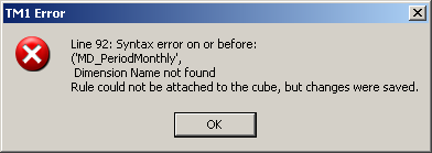

I have created a rule using Attrs, as you can see on the left side Attrs works fine, but when I replace '201211' on the right side i get the error message. Doesn't that work for the right side?

Post by Duncan P »
Does the cube on which the rule is defined have a dimension MD_Journal Number? If not then it will not be able to understand !MD_Journal Number in the rule.

sorry I was wrong, I mean
I have created a rule using Attrs, as you can see on the right side Attrs works fine, but when I replace '201211' on the left side i get the error message. Doesn't that work for the left side?

Post by Duncan P »
You cannot use any rule function on the left hand side. You need to set the attribute on the target dimension to show the appropriate item from the source and not the other way round.
In future to avoid this confusion it would help if you provided a little more context (as advised in the Request for assistance guidelines (PLEASE READ)) which in this case means the full text of the rule statement that is failing (and not a picture of it) and pictures from Architect of the dimensionality of the cube in which the rule is defined (the target) and the cube that is the source of any DB statement?
