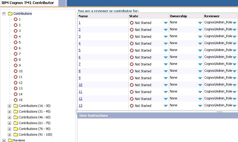

Elements in Contributor hierarchy shows in applications groupping in 15 elements.
For example hierarchy consists from items and user is responsible for 31 items. And he sees 3 folders when he opens Contributor - one with first 15 items, second with next 15 items and last with 1. It is quite incovinient. What I have to do for user can see all his 31 items without any folders.

Can you show a screenshot? I've not seen this before.

I'm happy to proven wrong, but I don't believe you'll be able to change this directly. You could introduce consolidations, that may clean things up a little bit. Though it'll really just replace the folders with consolidations.
