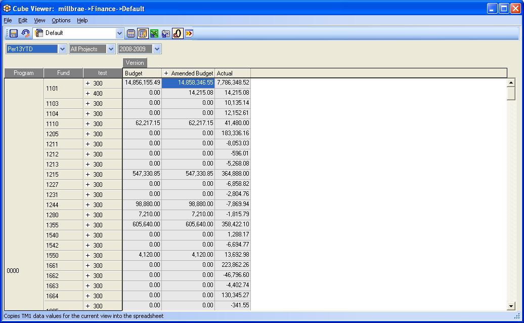

I just started to get this error- haven't seen this before today. I'm simply trying to slice data from our Finance cube into Excel and save it. I get all the way up to the point of the name and location of the file, click on save, and Excel crashes. Here is the cube view that I am trying to slice:

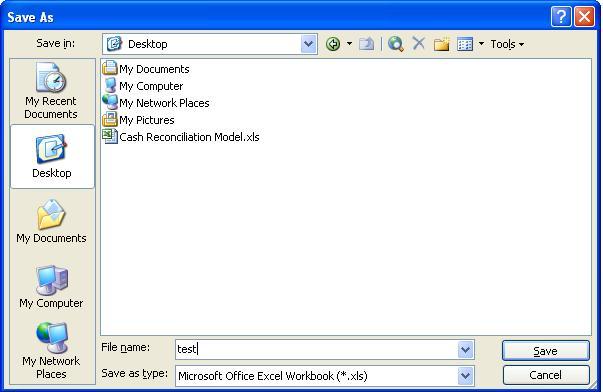

Here is the Save As window:

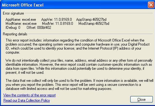

This is the error message that is displayed:

Just noticed that you have a program name of "0000" in your dimension. It's possible that excel interprets this as a blank cell at some point and then the slice fails. Do you get the same results with this cube with a different project number?

Hmm might be right there. TM1 would see that (if it was a data point) as empty. Excel would always see that as a blank cell. If the slice is trying to calculate values in Excel based on an "empty" cell as an element reference there is more than a slight chance it would get its knickers in a knot and die horribly. Steve's suggestion will prove or disprove that, try the same slice but without that element in and see what happens. If its fine then you'll have to get your users to agree to a different element naming convention :)

It's gone. The IT guy came over and took a peek at the Process Monitor that was filtered just for Excel processes. Seems like the point of crashing was when it was trying to write to 'desktop.ini'. When we tried to locate the file via windows explorer, it was nowhere to be found, even with hidden files and folders being displayed. We searched for the file, and the OS "found" it in the docs&settings directory under my username, but we couldn't visibly see it. He decided to run a chkdsk /f to see if any indexes had been corrupted, and I also remapped the shortcut to tm1p.xla on my desktop, just in case. I also downloaded/installed Office updates (although most of them were generic 'security updates' for Office; only one of them was a specific 'security' update for Excel). Now I can save the worksheet without crashing the app. Thanks for your suggestions and comments!
