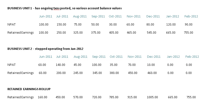

Now, the issue that's occurring is, let's say there's a particular business unit that's no longer having txns posted against it, so from, say, December 2011, the ongoing balances of any accounts for that business unit are $0.00. So, the overall "NPAT" total for that business unit is also $0.00. It seems that from that point (ie. Jan-2012) onwards, the rule for retained earnings is no longer applied, so the amount for "9510" for Jan-2012 shows as $0.00. (then the same for Feb-2012). (I've done some reading in the TM1 doco and it appears to me that even if there are "balance" records for a particular account, for a particular month, if those values are zero then TM1 will just ignore them. Is that correct? Is that ultimately the reason why the rule doesn't get applied?)
Attached is a image showing a quick example of what I mean. You can see from the sample image that once it gets to Jan-2012, the retained earnings balance stops being calculated, and then - ultimately - the retained earnings amount that should continue to carry forward into the subsequent periods is not contributing to the total rollup (eg. when viewing the same "Company" but ALL business units).

- TM1_retained_earnings_sample.jpg (70.03 KiB) Viewed 7171 times
