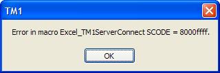

How can I gan access to the TM1 Excel macros?
For example access to the following macro:

Even one of my user is facing the above issue. Do you or anyone have suggestion on this, i was planning to reinstall the TM1 perspective on the user machine. Any other alternative available.

Try getting the user to close TM1 and Excel. If that doesn't work then try restarting the client's PC. That will usually make it go away.

Is there a way to access these macro's, though?

No, not unless you know Cognos' password. tm1p.xla is password protected.

Yep, we get it here occasionally too, a restart of the TM1 client / Excel usually fixes it.
