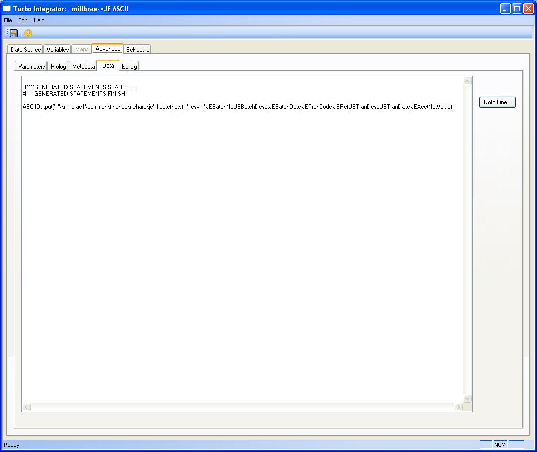

I'm hitting a minor bump. I think my syntax may be wrong for the ASCIIOutput function:

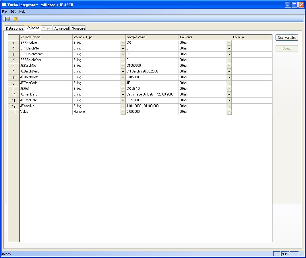

I created the cube view as you had suggested, and instead of using the ATTRS function in the TI process, I thought I could just record an expression for that specific dim (JEBatchNo) that selected elements by attribute (selecting data where the "Imported" atttribute is set to null).

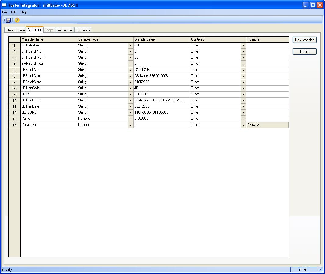

In the event that this is helpful, this is the Variables tab-

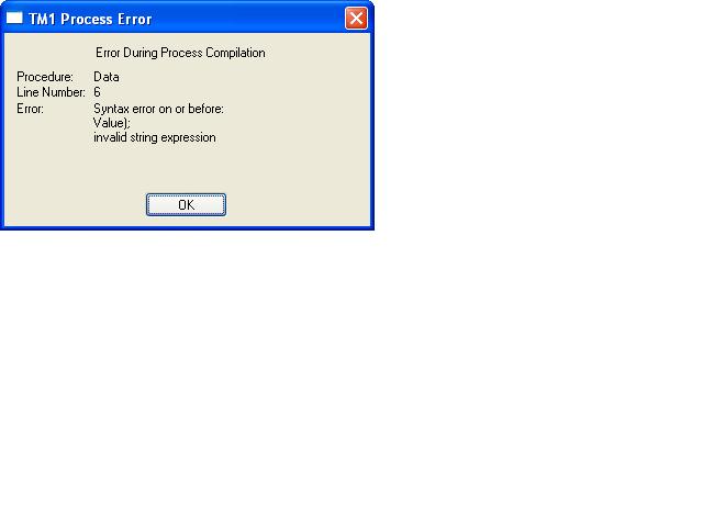

This is the error I get when trying to run the TI process:
Thanks again for looking into this. I appreciate it.

shinymcshires wrote:Steve-
What you're getting isn't a run time error, but a compilation error; that is, a problem with the syntax of your code.
When you use AsciiOutput, all of the fields that you export need to be strings, not numeric values. You therefore have to use either the Str() rules function or, if you're on a late enough version, NumberToStringEX to convert the Value argument into a string.

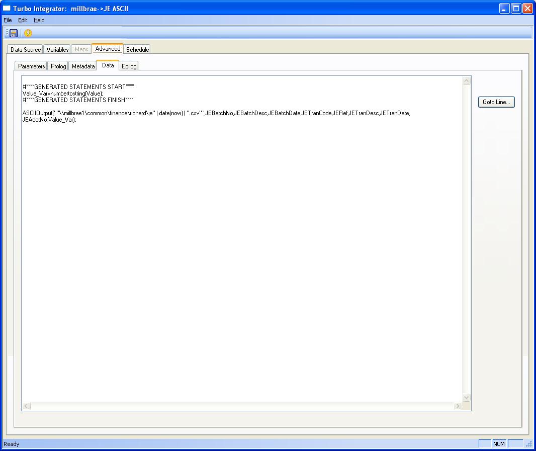

Thanks for your helpful suggestion. I changed the Value variable using the numbertostring function:
I also revised the ASCIIOutput function a bit to use the new Value_Var variable:
I think I have the file parameter syntax wrong for the ASCIIOutput function wrong- I'm trying to concatenate the current date as the file name in the UNC, but I don't have it quite right:
ASCIIOutput(' "\\millbrae1\common\finance\richard\je" | date(now) | ".csv" ',JEBatchNo,JEBatchDesc,JEBatchDate,JETranCode,JERef,JETranDesc,JETranDate,
JEAcctNo,Value_Var);
Here's the error log file:
"CR","105","02","2009","C1050209","CR Batch 105.02.2009","02052009","JE","CR JE 17","Rec Contract Classes P & R","02052009","1215-0000-101100-000","227.",Data Source line (1) Error: Data procedure line (7): File " "\\millbrae1\common\finance\richard\je" | date(now) | ".csv" " not found.

Oops. Just noticed that the Value_Var variable is not set to String. I've changed that now.
