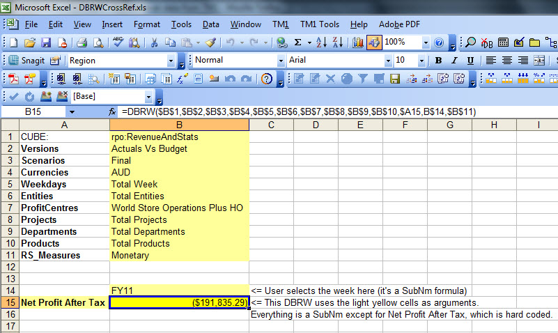

Let me see whether I can explain this graphically. You start out with a report based on a standard slice. The DBRW is in the bright yellow cell. The arguments are in the pale yellow cells. All of them are SubNm functions except for the account in cell A15, which is hard coded. The Weeks value is in B14, and is also a SubNm. This works fine.

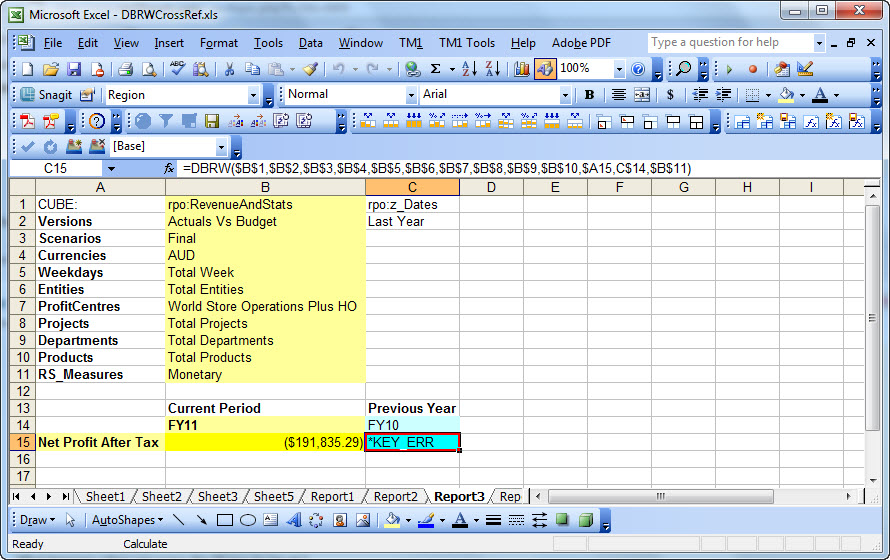

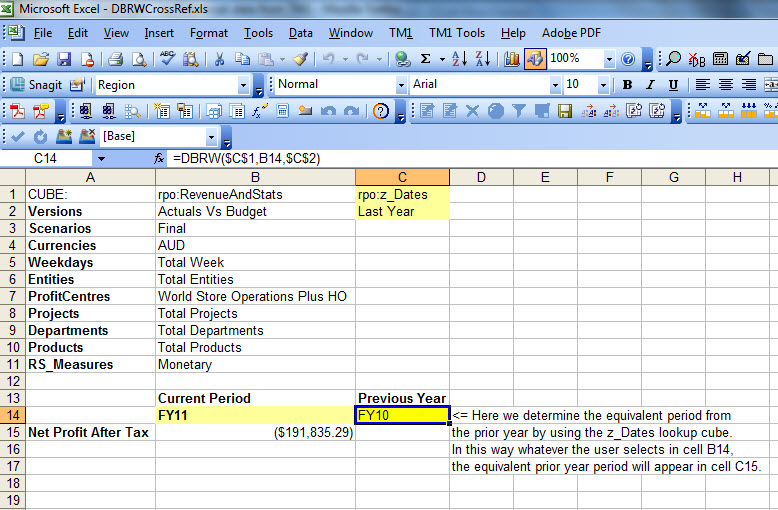

Now suppose that we want to put a second column in which shows the values for the corresponding period in the previous year. In this model there's a cube that can do that called z_Dates. It has two dimensions; one shows all of the dates, the other the lookup values. We can then create a DBRW formula to look up the "Last Year" value for whatever period the user selects. Again the formula is in bright yellow cell C14), with the arguments in light yellow.
So far, so good. However let's now add a DBRW which uses that prior year value. It goes into cell C15, and points to the same cells as the original one except for the Weeks dimension, which uses the calculated prior year value in C14 instead of the SubNm formula in B14.
What happens when we press [F9]? This does:
Why?
Because when we hit [F9] TM1 tries to recalculate all of the DBRW formulas at the same time. The problem is that it can't calculate C15's value without knowing the value for C14, because it needs to know the week that you want to use. And since C14 has yet to be calculated, C15 can't know the week dimension element and the result is a key error.
However if you edit cell C15 by itself instead of pressing [F9] you will get the right answer because when you edit a cell, that cell and that cell alone is being calculated. Cell C14 won't be calculated, which means that it still has its original value. That means that C15 will be able to use that value. And that means... it won't have a key error.
To repeat, the only time that there will be a problem is when you press [F9], at which time TM1 will be trying to calculate C14 and C15 at the same time, with C15 failing because the calculation of C14 is incomplete.

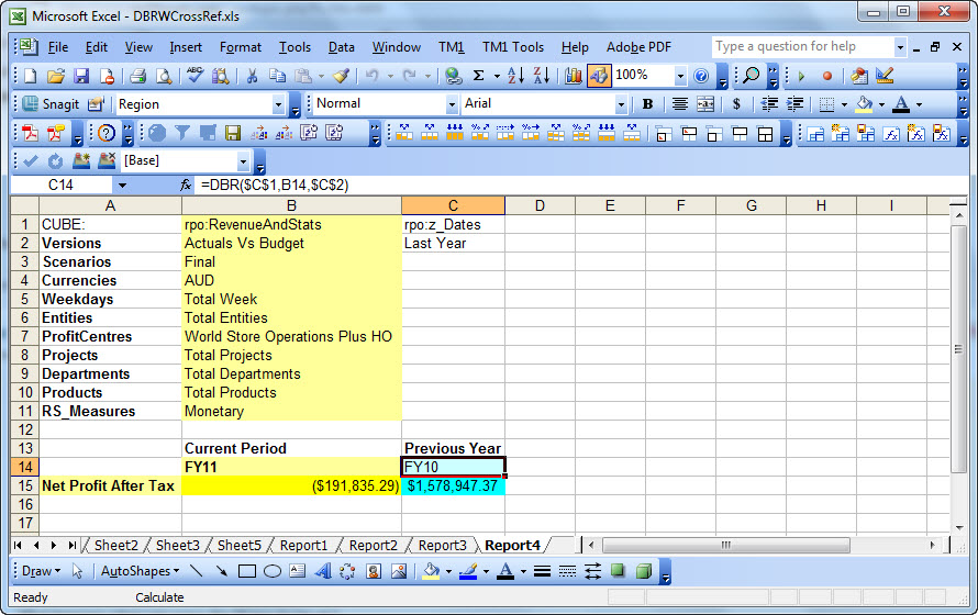

The solution to this is to change C14 from a DBRW to a DBR. DBR's are calculated singly rather than in a batch which means that when you hit [F9], TM1 will calculate C14, then calculate all of the DBRW forumulas.
This sounds like the situation that you're describing.
What you would need to do is change any cells which are like C14 on your own sheet to DBR's. (That is, any DBRW's which other DBRW's rely on.)
