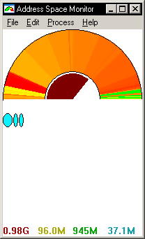

Re: Adding ATTRPUTN
Posted: Wed Dec 14, 2011 10:20 am
by Duncan P
OP doesn't say which flavour of 9.5 he is using but in 9.5.2 the 8000 character limit no longer applies to manipulation of string variables. The lines
v = FILL('1',400000);
ASCIIOUTPUT( 'd:\temp\qq.txt', NumberToString(LONG(v)));
produce a file with the following line
"400000"
so the variable is there and it has 400000 characters in it. If however I try to ASCIIOUTPUT the string itself I get nothing. There appears to be a limit of 64999 on the length of the overall line output in a single call to ACSIIOUTPUT.
So you would think that the concatenation would be OK still. However that is not the case. A simple test looping while concatenating a character to a variable and then outputting its length shows nothing after about 44399. However if I look in the server log it has the following error message :-
4068   [2]   INFO   2011-12-14 09:26:16.562   TM1.Process   Process "qq" executed by user "Admin"
4068   [2]   ERROR   2011-12-14 09:26:22.968   TM1.Server.Memory   AllocateBlockFromOS: alloc (size = 44319) failed: (null)
4068   [2]   WARN   2011-12-14 09:26:22.968   TM1.Server.Memory   AllocateBigBlock() outOfMemory Exception <<< MEMORY_FATAL_LEVEL >>> -  apifunc# "196"
At the time of the failure the process (32bit) had just over a gigabyte allocated. What is probably happening is that of the available 2 Gb of address space there is not a single continuous block of the 44K required. This will be because each loop is allocating a block one byte larger than the largest one used so far and so TM1 is having to go to the operating system to give it another one. Furthermore TM1 is not giving back the previous blocks but is hanging on to them while the process is executing which means that the OS is allocating from an ever depleting pool. Using Address Space Monitor (http://hashpling.org/asm/) I got the following map of the address space just before it died.
So concatenation is not a goer, but in 9.5.2 not for the reasons stated in previous posts.
Besides rmackenzie's suggestion is much the better one in this instance. :)
