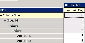

Am trying to modify a element level security TI process build by me. I gave user the flexibility to flag N level elements in a product dimension. (I created a mapping cube taking products Dim and a dummy measure to hold the flags). And wrote a TI process to read all these flags for N level products and putting security in }ElementsAttributes_Products cube to write or None
Issue:
By the above process am only able to get the flag values at N level products and say that
##A while loop runs through all products
IF(cellgetN,MappingCube, product,measure) = 1 );
Then i put None in seucity cube and
IF(CellGetN, MappingCube,prroduct,measure) = 0 );
Then i put Write in security cube
so on for all elements...
Now i want to put None if all the N level elements of a C level Parent in Product are flagged with 1's .
How to get a parent Name of whose all N level children are given values 1's
Identify Parent Name on child flags

- Mapping Cube
- Mappingflags.JPG (10.78 KiB) Viewed 6919 times

You could iterate over the parents only and compare the value at the intersection (of the parent and 'Not Valid Flag') to the number of children in that parent (i.e. using ELCOMPN). Where the value equalled the number of children you have a parent that should have NONE for element security.vinnusea wrote:How to get a parent Name of whose all N level children are given values 1's
For this to work, you'd need to have standard element weightings in the SKU dimension (i.e. the default of 1). In the screenshot, the child SKUs don't appear to be consolidating... it actually looks like you have given them zero weight in the SKU dimension which strikes me as quite a strange thing to do... perhaps I have got it wrong?

If I have understood correctly you have used the attribute cube to hold the 1s for the security mapping. This explains why the values are not consolidating. If you use an ordinary cube instead then the values will roll up and Robin's suggestion will work. (for level 1 parents only though mind you, if you want the same logic to flow higher up you could use the same logic but would need an additional measure and a rule.)
Bear in mind though that with this security schema the user will see a the full value of any parent even if they can see only a limited number of children which could be confusing for users if they expect the parent values to equal the subtotal of the children they can see.

First of all i apploze to miss to provide some information. I have written a rule for this mapping cube saying [Not Valid Flag] = C:0; . That is the reason why its showing Zero's at C level. I have done this just to provide a clean N level flagging to Users. By that they enter flag 1 if N level element is Not Valid and hidden.
Yes, as per rmackenzie & lotsaram advice i have to remove this rule and see the C level rollup is equal to total number of child's then HIDE.
