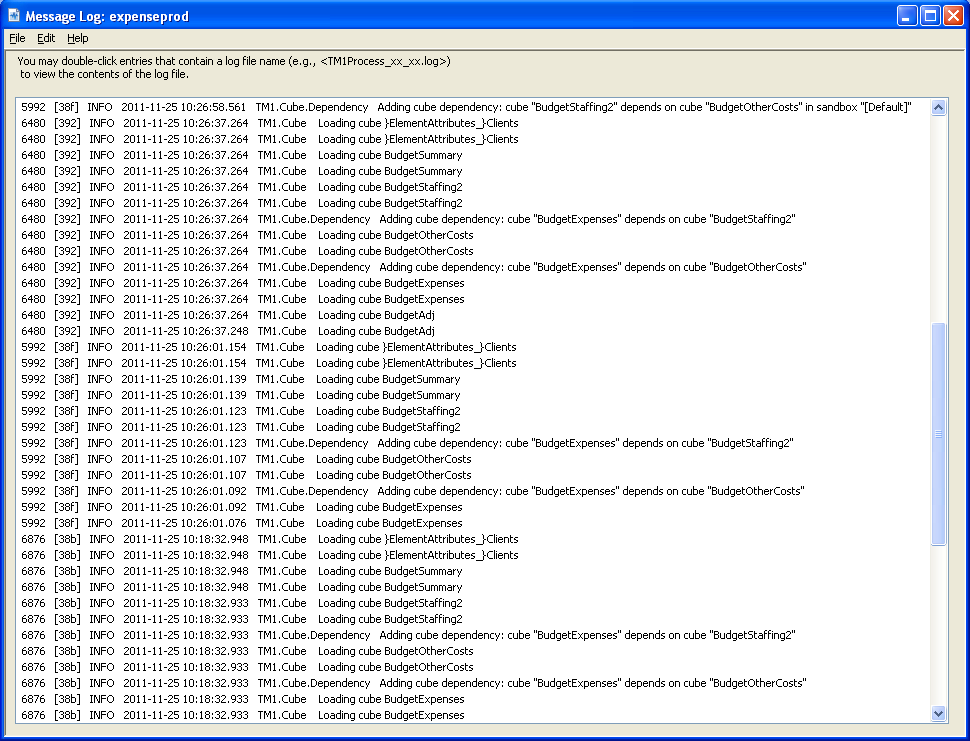

I have run a TI that sets cube dependencies (in the correct order per the other discussion).
But, when I look at the log, I still see many instances of those same dependencies being set. And many "cube load" messages, for cubes that are already loaded. I have attached a small sample of the message log.
Any idea why I would be seeing this behaviour? (I still need to triple check the setting of parallel interaction, which my IT guys assure me is set on correctly.)
I think I'll continue this topic, as the other topic is getting quite long, and I'm about to get more specific.
