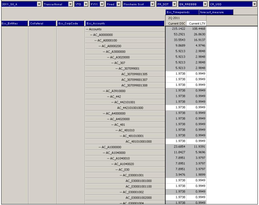

We have a requirement, according to attached scenario :
For every consolidated account number, for instance, just say that we dont want the aggregation of the leaf level elements , inspite we just want that every consolidated node have the same value as the leaf node have.
Just for example : For Current DSC if we take account number -> "AC_307099001038" then every of its subsequent consolidated account should with hold the same value i.e. "1.9738". Every Account(at leaf) for each Ess_Entity dimension will hold the same data i.e. "1.9738"
We are feeding the leaf level data using TI.
Any suggestions are welcomed.

I don't quite get why you'd want this - are you saying the up the entire chain of the hierarchy, from 'AC_307099001308' through 'AC_307' up to 'AC_A000000' and then 'Accounts', you want the value has to be '1.9738'?
Why? When you get to 'AC_A0000200' which value does it take on, 'AC_307099001305' or 'AC_442101001000'?

So you basically just want to designate one N element in each consolidation branch that will consolidate up, whereas all others should not. Putting aside the question whether this should be done at all, this can be easily achieved by setting weights of all the elements that should be ignored in a given consolidation to 0 while keeping the weight for the chosen element as the default 1.
This however, will only block consolidations up to a point where different hierarchy branches meet. So element "Accounts" for example would still be a sum of all the N elements that have a non-zero weight, not just a chosen one. That is, unless of course you use the weight trick on consolidated elements as well, in which case you can always block any branches from consolidating at the level of your choosing.
Also, note that this solution has a big drawback - it's not transparent and intuitive to users. However, if you want to go that way...
