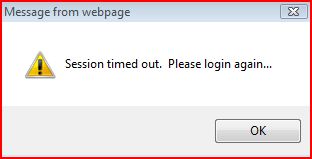

i already solve the problem regarding the unable to open "link" cannot download the information you requested by editing the hyperlink and input the same link to address and click ok....but now my problem is when browsing the TM1 Web the "SESSION TIMEOUT..Pls.LOGIN AGAIN....."
Can you help me solving this???? thank you....
- session timeout.JPG (15.58 KiB) Viewed 3466 times

If I recall correctly I ran into this error message one due to being unable to write cookies. When running TM1 web in cookieless state (in webconfig) everything worked OK.
