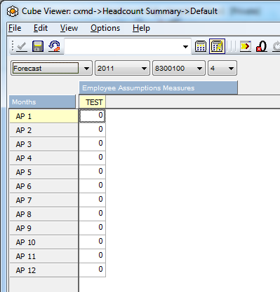

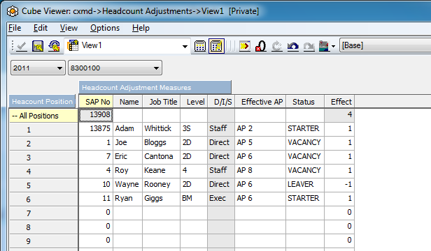

I have the following cube which I want users to input data. To make it easier for them I have created a cube with many measures rather than many dimensions.
'2011' = Year, '8300100' = Cost Centre. I want this data to summarize in the following cube:
'Forecast' = Version, '2011' = Year, '8300100' = Cost Centre, '4' = Employee Level, Months, and 'TEST' is where the summation of 'Effect' from the input cube should appear. In the view shown on the summary cube; Roy Keane effect of 1 should be showing in TEST for AP 8.
I am really struggling to get my head round how to sum this information up using a rule, rather than a TI process which I think would be easy to write.
Can anyone offer me any advice, whether it's that I'm going completely the wrong way about gathering the raw information, or whether you can help with the rule side of things.
Cheers.

I don't think you can do it with a rule, based on the current cube design.
The reason I say this is that you are trying to obtain values based on the month in which a position's 'Effect' has an affect on the total, however you are storing all this data in a measure which makes it difficult to obtain the proper consolidated value using a rule.
To consolidate for 'AP 8' you need to be able to say "consolidate all Headcount Positions with an Effective AP that is less than or equal to August", but in a rule there is no way to scan through all of the Headcount Position elements and only grab those which match this description.
You could create system consolidations in the input cube called i.e. 'AP 8' and use TI to add Headcount Positions that match the condition "If Effect is less than or equal to 8"....however;
from the looks of it, you also need to segregate your data based on Employee Level, so using system consolidations means you would need i.e. 'AP 8 - Level 1', 'AP 8 - Level 4' etc.
...so I think you either need this dimensionality in your input cube or you need to use TI to put it into the reporting cube.

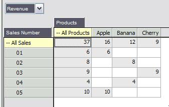

You can do it using rules but you need to introduce an extra cube in the middle. I'll illustrate with a rather simpler example, imagine you have this source cube:
And you want the following summary
You can do this by creating an 'intermediate' cube to go in the middle. This should have all the same dimensions as the 'Summary' cube plus the 'Sales Number' dimension.
The intermediate cube should have rules:
Now you can take the 'All Sales' slice of your intermediate cube and copy into your summary cube:
Doing this with the correct feeders is more tricky ... if your example is small enough you can do it without using SKIPCHECK & FEEDERS. If you do need to use SKIPCHECK & FEEDERS the main thing is that you can use a conditional feeder from the 'Sales' cube to the 'Intermediate' cube.
