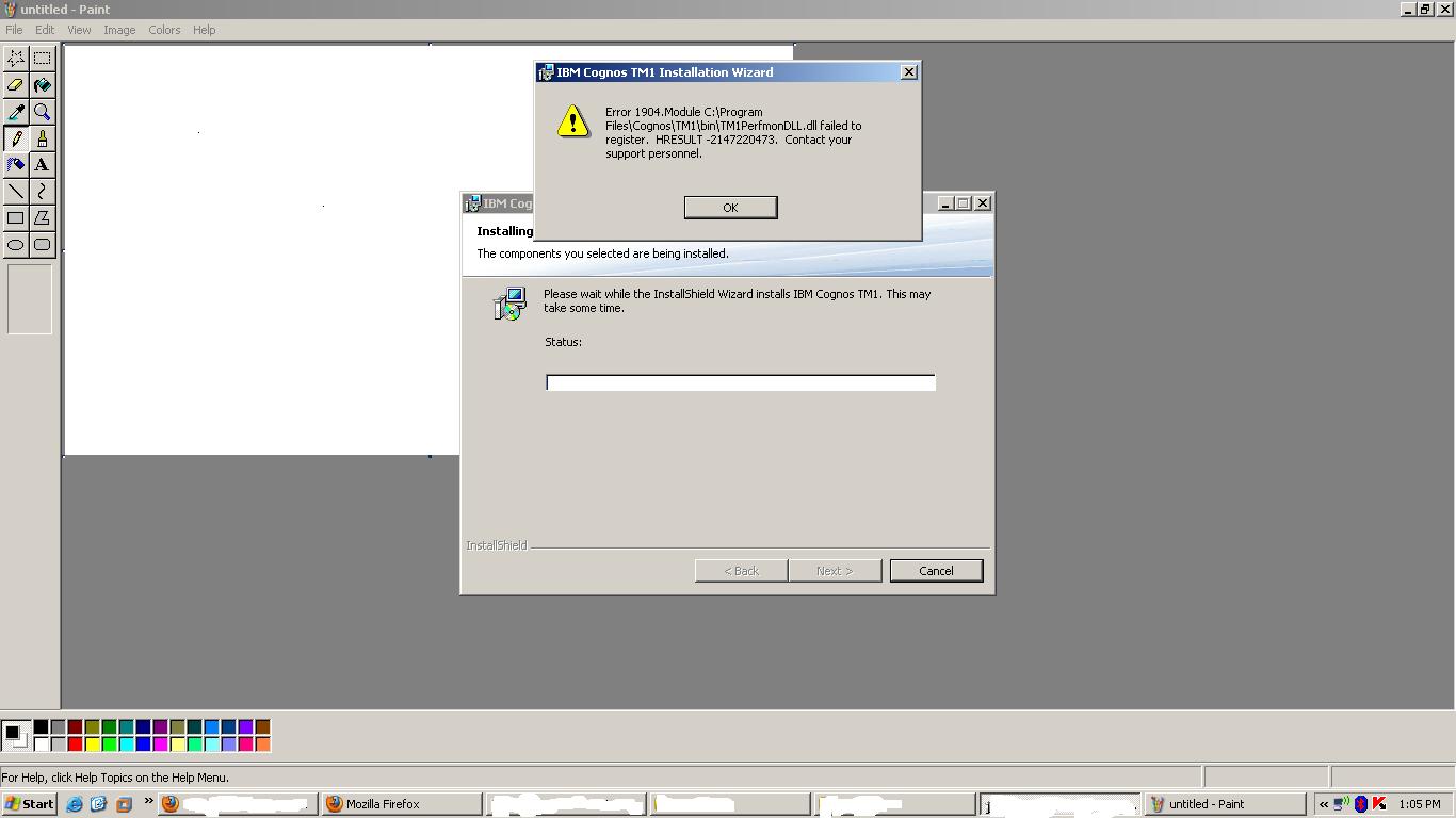

HI,
Please find the attachment for the error.
The error while i installing TM1 9.5, can help me what i am missing any files.
Thanks and regards
TM1 9.5
Excel 2007
ERROR 1904-Installation Error

Re: ERROR 1904-Installation Error
which OS are you using?
Windows XP,
What happens if you manually register the DLL bin\TM1PerfmonDLL.dll using the DOS command regsvr32.exe as outlined in the IBM Technotes 1351362, 1450379 or 1351412 ?
https://www-304.ibm.com/support/docview ... wg21351362
Error message in server log on startup - Failure initializing Performance Monitor: 80070002
http://www-01.ibm.com/support/docview.w ... wg21450379
TM1 performance monitor doesn't work after installation
http://www-01.ibm.com/support/docview.w ... wg21351412
TM1 Performance Object is not displayed in Performance Object list
Note:
The Windows user to execute the DOS command regsvr32.exe must use the US English Regional, Culture and Language Settings: He must use US English as the language of his Windows environment.
