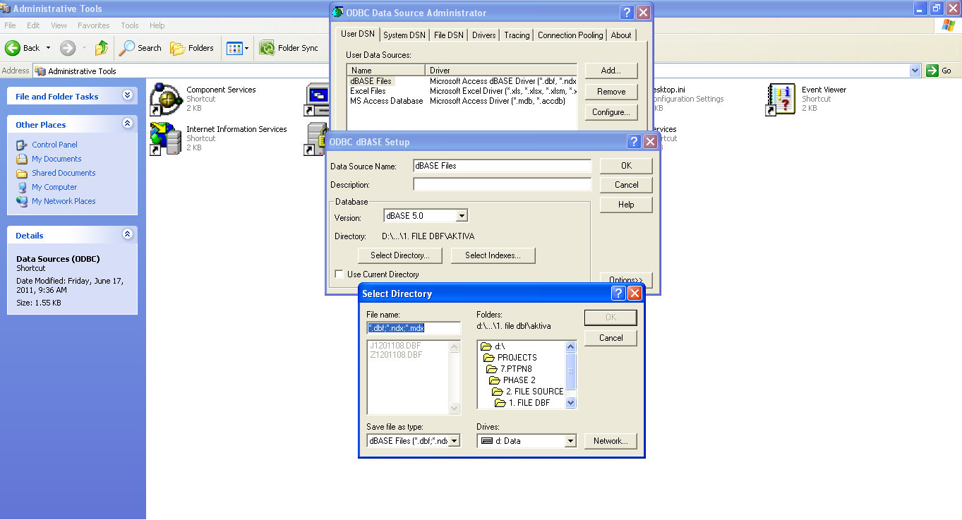

Re: Accessing DBF (Database File) using TI
I can access DBF using TI.
1. Open administrative tools
2. Double click odbc
3. Choose dBase Files and click configure
4. Click select directory, point to your dbf files directory
5. Click ok.
In TI, choose odbc and dBase driver, then you can select your dbf file name.
Hope it will be useful.
