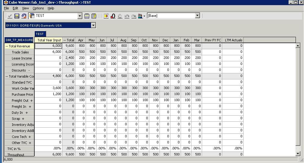

My time dimension has these values:
Total Year Input (n-element)/Total (C:element)/Apr (n-element)....../Mar (n-element)/Prev FY FC/ LTM Actuals
I wanted to achieve that the value of the Total Year Input will be distributed to the months.
But for some reason , It worked only in one row (normal rollup of APR-MAR to Total).
For Work Order Variances and Purchase Price Variances it did not.
So I put these feeders in. APR >Total.
What is not working now , is the Throughput (only sums up the values from the derived rules, not the ones which are entered at the N-level (Apr-Mar)
This is my first project in TM1.
Unfortunately, I do not know now how to distribute the Total Input to the relevant months.
So I came up with this simple solution.
Thanks for showing me the trick.
How should I proceed?
Erik
thanks for your reply.
Erik
