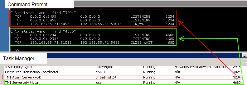

I have searched one more time and I see both ports 5495 and 5498 are used by "TM1 admin".
TM1s.cfg PortNumber is set to 12345 and ClientMessagePortNumber is set to 12346.
I have tried to telnet to remote ports from my notebook:
telnet ip_address 5495
telnet ip_address 5498
telnet ip_address 12345
telnet ip_address 12346
All connections are responding fine.
See attached picture - task manager PIDs and tcp ports numbers match.
Is there any other settings that I need to be aware of?

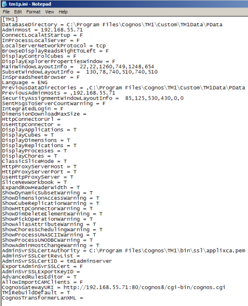

I have checked the C:\Program Files\Cognos\TM1\bin\ssl\ folder and it exists and *.pem files are stored in there.
Now I have uninstalled TM1 Architect from my notebook and installed whole TM1 typical install (so now on my notebook are installed: tm1 architect, tm1 all APIs, tm1 perspectives, tm1 client, tm1 admin server and tm1 server).

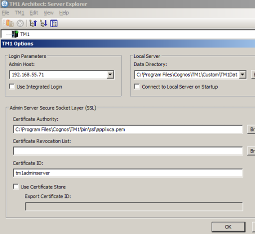

Opened TM1 Architect and set IP address of TM1 admin server settings in File | Options. Then exit Architect to make sure this settings are stored in tm1p.ini file. Opened this file and also set the CognosGatewayURI settings.
Disabled TM1 admin server and TM1 server on local notebook and started TM1 Architect. The same problem. The server list is empty.
Do I need to set some other settings in TM1 Architect or in tm1p.ini file or somewhere else?
I am attaching the TM1 Architect Options window and a tm1p.ini file.

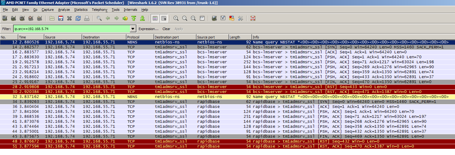

I see netbios was disabled on my PC, I was strongly convinced that nowdays there isn't any service that uses NetBios protocol. So in Windows XP I enabled it back by:
1. Start | Settings | Control Panel | Network Connection.
2. Right click on "Local Area Connection" and selected Properties.
3. From connection list I have selected "Internet Protocol" and cliked Properties button.
4. Clicked on Advanced button.
5. Clicked on WINS tab and checked "Enable LMHOST lookup" and set "NetBIOS setting" to "Defaul".
Then I started TM1 Architect and now I see some network traffic on Wireshark on my PC (see attached picture) and also on Wireshark on my server. But TM1 Architect server list is still empty.
Any idea what else is wrong? Why doesn't TM1 Architect returns any error/warning? It is difficult to tract what is wrong if no info is returned.
