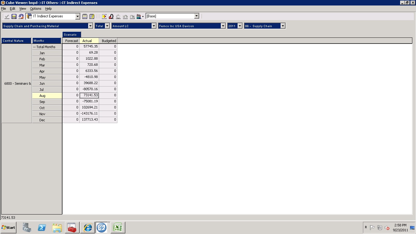

result when i put it in the epilog tab.

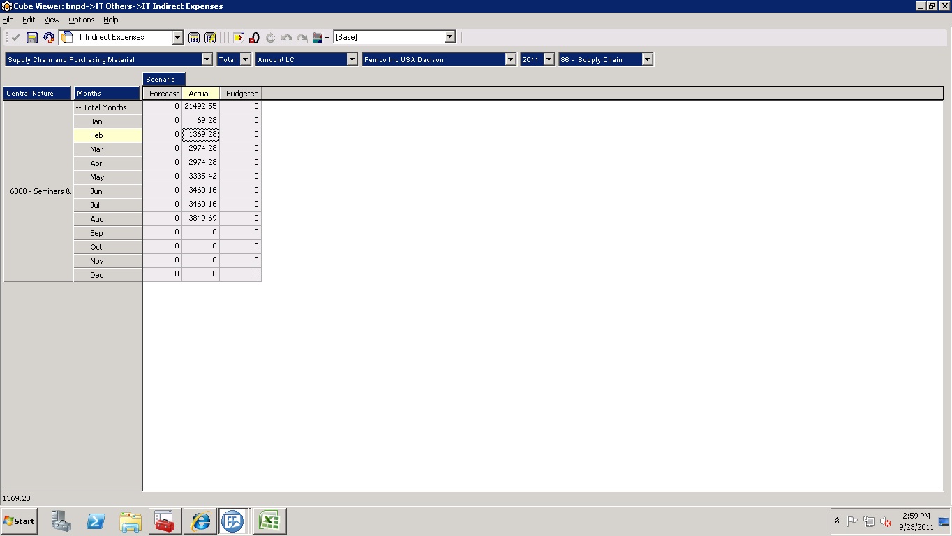

Result if i put the code in the data tab.
Result(data tab).jpg (127.58 KiB) Viewed 7977 times
