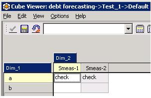

The test is relatively simple btw create
dim1 = {a,b}
dim2 = {S-meas,S-meas2}
# test cube rules
feedstrings;
skipcheck;
# nb have to code rhs of string rule as DB
['S-meas2'] = S: DB('Test',!dim1,'S-meas') ;
feeders;
['S-meas'] =>['S-meas2']  ;
Go into the cubeviewer and enter a value against a and then start performance monitor.
If you get 2 fed cells then its feeding the entire area regardless. If you get 1 things should be oK
Would be interested to see what 9.5X users get.

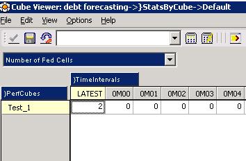

Hi John,
I have tested it in 9.5.2 HF 5.
I am getting 2 fed cells for a single string entry. Screen shot below.
Anybody knows whether this is already logged as a defect with IBM ?
Anoop

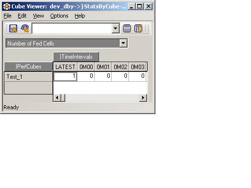

Thanks Anoops - here is the result in 90. It is the correct one and this illustrates that there is a severe bug in 951/952 as LotsaRAM has pointed out. So the upshot is dont feed strings in 95 until they have corrected the problem. I cant raise the bug myself as I am on 90 but a URL to this example should be enough for IBOGLIX to reproduce the bug themselves and fix it in time for Release 11.
Iboglix I find you guilty of Overfeeding
