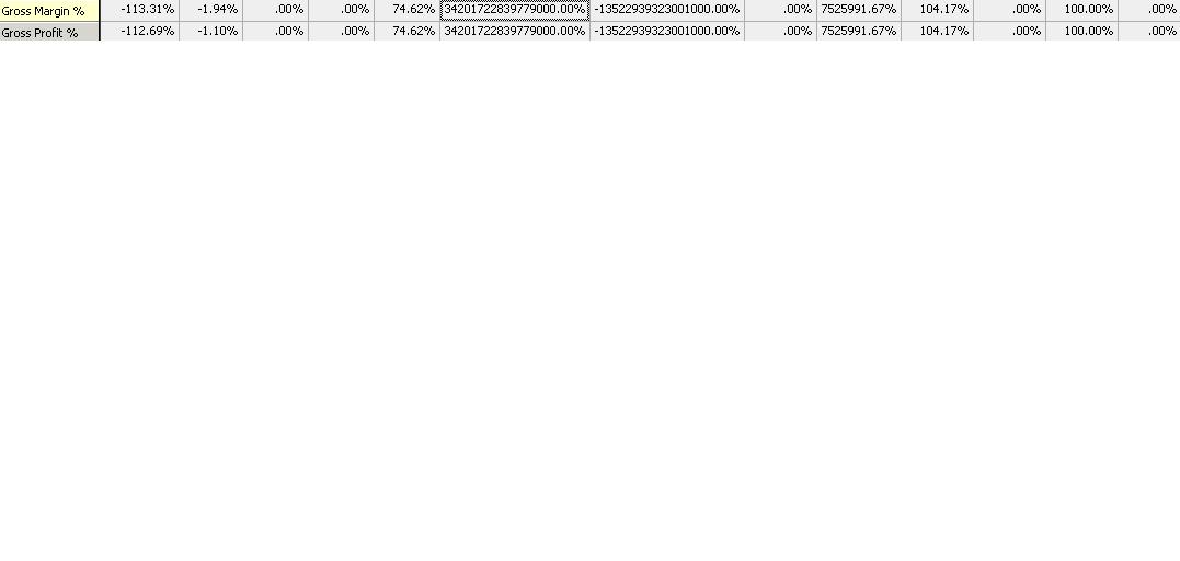

I am not too sure to resolve this issue at a cube level.
are you saying that I have to write TI process/rules to resolve this issue?
attached screenshot-where are the values are calulcated by dividing 0(zero)
what could be the IT process or a rule- please advise.
Ravi

- qml
- Posts: 1098
- Excel Version: 2007 - 2016
Re: Precision values tm1
Surely these lovely numbers you have shared with us are a result of some calculation, which is either a rule, or a TI, right? I'm hoping you are able to find that calculation and then spend some time thinking what is actually happening and how you can apply the suggestions from the above posts to that calculation to alleviate/solve that particular problem you're facing.ravi wrote:are you saying that I have to write TI process/rules to resolve this issue?
