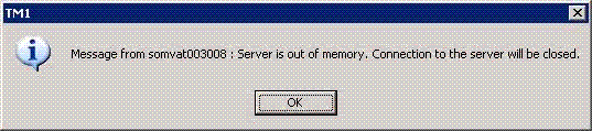

Hi All
I am also experiencing similar problems.We have a 64 bit server -128gb of ram.
Screen dump of Warning message
Memory Error.jpg (354.3 KiB) Viewed 11287 times
Any comments or ideas?
Cheers
Armand
jim wood
Posts: 3971
Version: PA 2.0.7
Re: Server 9.1 SP3 U1 - Memory Exception
Post by jim wood »
The issue we encountered was a compiler issue that is fixed in U2,
Jim.
