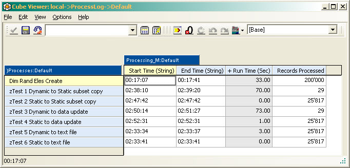

I also decided to do my own experiment. Maybe this is a little more scientific than Mike's, probably not that much, but it certainly is repeatable. I decided on 6 test cases to compare between processing performance of dynamic vs static subsets. The tests are in 3 pairs (meta data change to model, data change to model, no change to model). Everything was tested on 9.5.1. The tests are:
- copy dynamic subset to static subset
- copy static subset to static subset
- process dynamic subset and update attributes
- process static subset and update attributes
- output dynamic subset to file
- output static subset to file
The dimension I used was sizable (100K leaf elements with 10 levels) but definitely not huge by any means. The MDX expression relatively simple but giving the server some work to do:- recursive drilldown on top level element, filter for N elements then filter on member name to exclude parts of the dimension.
The results speak for themselves. Using dynamic subsets as data sources is a no go. I haven't done this for a long long time but I was surprised by the extent of the impact. I started out wanting to run tests with sizeable dynamic and static subsets with identical members, but quite honestly I gust gave up waiting for the process to ever finish with a sizeable dynamic subset as a data source and so ended up cutting the dynamic subset down to a level where I could be bothered waiting. If someone can come up with a case where it is faster to read from a dynamic subset I'd like to see it.
As expected if anything in the model is updated then processing performance with dynamic subsets barfs, processing speed on a simple file out is comparable but you still wear some additional overhead for evaluating the MDX versus reading straight from the static list. This combined with the performance difference in subset copy is a perfect example why it is best practice to output a dynamic subset to a file then use the file either for subsequent processing or to create a static subset. It may be more work but it is simply faster.
I think Mike also hit the nail on the head with the distinction between faster to code versus faster to run although with reusable code snippets and modular TI coding from bedrock I'm not sure I buy the argument that a dynamic subset is quicker to code than a static one. It's pretty clear to me that as a developer you have a responsibility to code an application that runs as fast and efficiently as possible, you also never know when more users, impact of locking or slowdown from evaluating rules and feeders might come to bite you ...
In the interests of education, scientific method, peer review and all that I have this available as a demo model so anyone else who wants to replicate this is welcome to do so. Just PM me and I will email it to you as I got the zip down to 2MB but still nowhere near the 512KB upload limit for attachments on this board. (If anyone would care to suggest a file sharing alternative to emailing let me know.)
