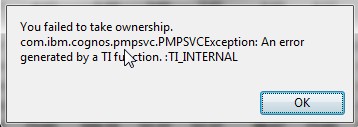

I have a problem with a TM1 contributor application, I want to take ownership of a node on c-level and i ghet the next message;
SH_ 2011-08-3001.jpg (11.24 KiB) Viewed 4830 times
I have set submit rights to the node for the user in Contributor, I also did this for the n-level leaf nodes of this element. What I do see is that when I submitted all leaf nodes I can submit the c-level node. But I still do not have ownership, I can't for example make a sand-box. Is this normal behaviour? I can't find anything about it in the manul's or on the web.

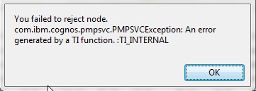

I also get the next error message when i reject a submission (as admin) from another user, but when I go back i can see that the rejection did take place.
SH_ 2011-08-3002.jpg (11.02 KiB) Viewed 4830 times
I also don't find any errors in the }tp_process_errors cibes

The error message suggests that a TI process failed, so take a look in the error logs and it should say why, or at least tell you which line of TI code is failing.

Indeed it is a problem in a TI-proces, it's an mdx statement which is generated in one of the TI proces generated by contributor (the }tp_... processes). I found an error in the processes;
}tp_workflow_enter_node, Is used while entering nodes
In the prolog line 196, here is a statement
SubsetCreateByMdx(vSubset, vMDX);
where vMDX is;
vMDX = '{INTERSECT(TM1FILTERBYLEVEL({DESCENDANTS([' | gApprovalDim | '].[' | pNode | ']) }, 0), [' | gApprovalDim | '].[' | gApprovalSubset | ']), ['| gApprovalDim | '].[' | pNode | ']}';
Filed this issue also with IBM, this is a known issue, you can't use a subset with the same name as the dimension in contributor (COGCQ00633058). This indeed solves the problem with entering nodes om c-level.
But when you now wan't to 'take ownership' of a c-level node you get another error message, which also in the end relates to MDX, in the proces
}tp_workflow_take_owner_group_on_consolidation
I returned this issue also to IBM, still waiting for reply.
