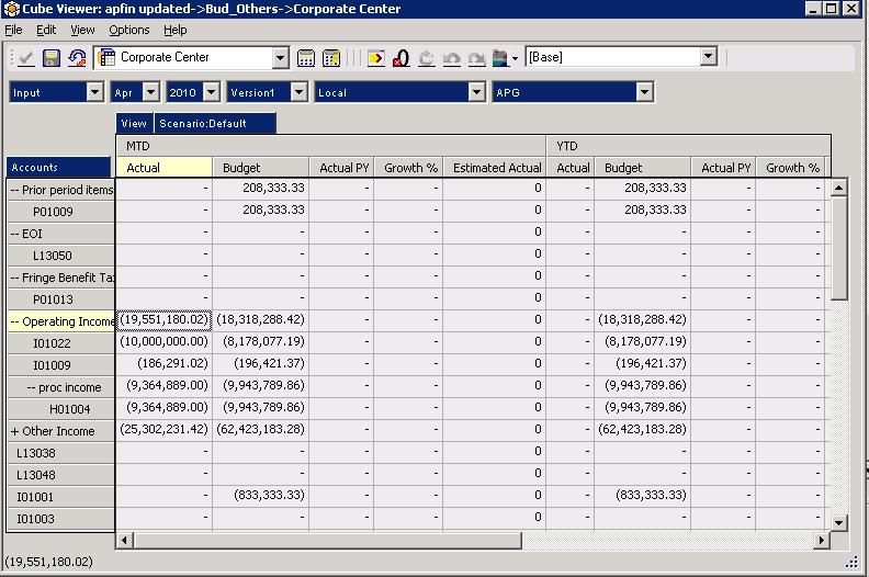

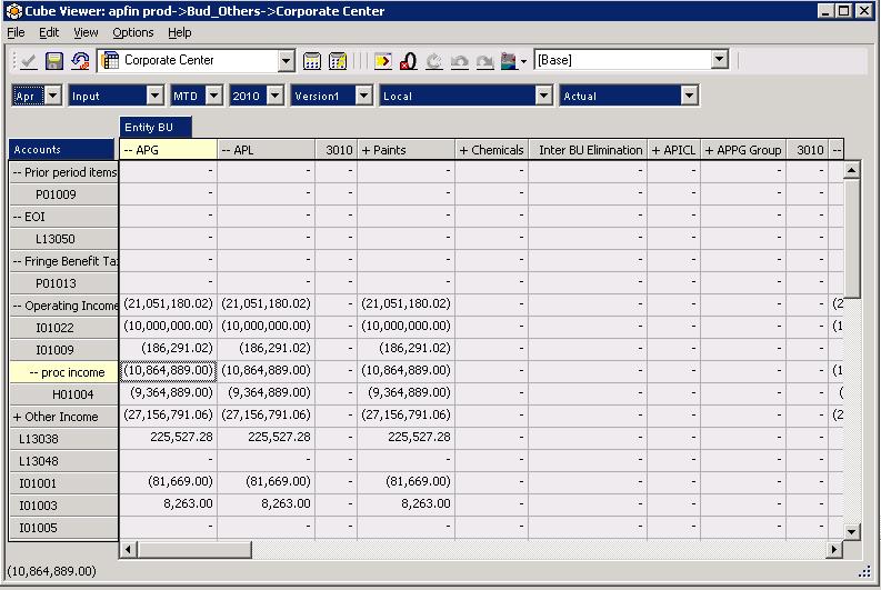

However the problem persists when i right click a consolidated cell and check feeders all cells show the status as not fed.
Thanks for the help and all the tips.

Hi so if i put the feeder in the GL Cube in this manner will it make sense? Because I have tried this still no result.
I have attached two copies of the cubes one is for the Production server and one for the server where I m doing the modification and comparing with the production server.
['Actual']=>DB('Bud_Others',!Entity BU,!Accounts,!Period,!View,!Year,'Actual',!Version,!Currency,!Input);
['Actual PY']=>DB('Bud_Others',!Entity BU,!Accounts,!Period,!View,!Year,'Actual PY',!Version,!Currency,!Input);
- Development Server Bud_Others Cube.
- Development Server Bud Others Cube.jpg (87.96 KiB) Viewed 8348 times
- This is the Production Server Bud_Others Cube
Notice the difference between the Operating Income Element in both cubes. - Production Server Bud_Others Cube.jpg (92.62 KiB) Viewed 8348 times

Yes, if the two lines you wrote above sit in the GL cube. It looks like the two cubes have the same dimensionality but the order is different.
Keep in mind that the error checking on the right side in feeders won’t tell you ‘hey, you are using the wrong order of dimensions’.
But the most likely reason why the [proc income] is not the same is because it looks like in production you still have the rule for both C: and N: level. And in this case having the screenshots from the two different servers doesn’t help figuring out what is wrong with the feeders in just one of the servers.
When I look at the first screenshot and the rules you have posted (again the latest version of both cube rules in development only would be helpful) I’d say that this rule should apply on the left column of it:
['Actual','MTD'] = N: if(['Actual','YTD']=0,0,['Actual','YTD']-if(attrs('Period',!Period,'Prev') @= 'Mar',0,DB('Bud_Others',!Entity BU,!Accounts,attrs('Period',!Period,'Prev'),'YTD',!Year,'Actual',!Version,!Currency,!Input)));
What strikes me apart from the feeders is that [Actual, YTD] is 0 (or “-“ so it could be formatting for that matter) and therefore MTD should be 0. So I am not sure which rules really apply at the moment.
Any ways, I suggest you focus on one rule and one feeder first.
I take it that [Actual, YTD, Version 1] comes from the GL cube. I this rule properly fed?
