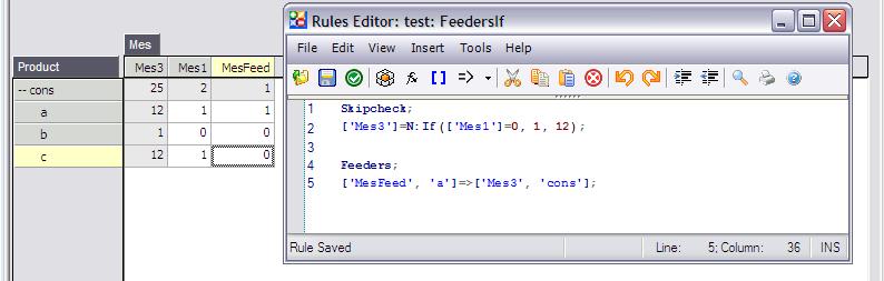

Re: Feeders for Zero values
Post by jstrygner »
maps wrote:Is there a way to feed the ['Mes3'] ? In the sense of flag all cells in ['Mes3'] ?
maps, if it helps, just see on the picture what I meant. I used here tomok's additional element approach, one filled cell is enough to feed the whole Mes3 column if you hit the top consolidation element in Product dimension (remember that the assumption was all the values are non-zero in the Mes3 column, so feeding all leaves does not cause overfeeding).
