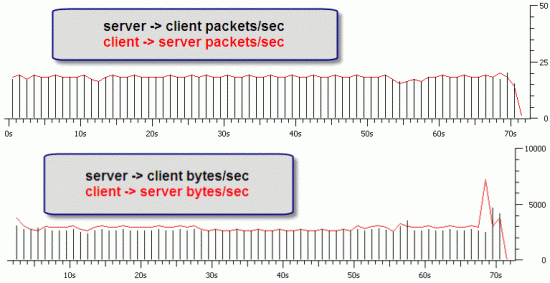

It's a slow week, so I (finally) installed Wireshark and started taking a look at this. I'm running TM1 9.1.4 x64 Server (remote) and TM1 9.1.4 x86 Perspectives (local). I ran these numbers while at home and connected over 8Mbit DSL and VPN, so that increased latencies a bit. Our concentrator is in the same data center as the TM1 server. For now, I'm just looking at Perspectives and cube viewer performance.
Opening my main P&L cube required 2,567 packets and 400 kB (r/t). Payloads were small: the average packet size was only 156 bytes (66% under 160B). I'm not really sure why the client->server bytes spiked at the end. It was one four-packet set totalling 4,394 bytes.
bytes and packets per second
From this, it's obvious why my WAN performance is so bad. Normal latencies were 40-60 ms so 50 ms * 1,300 packets = 65s, very close to the 71s Wireshark recorded. Everything appears to be sent one packet at a time with app-layer acks, so that many packets are emphasizing latency.

Thanks for your efforts. It seems that you are confirming what we found, namely that TM1 Client-Server communication generates a lot of packets. You mentioned that you had a lot of small packets. On our 54000 cell monster view we found that about the first 30 packets were quite small at around 150-200 bytes. However, after that the rest were 900-1300 bytes which is using most of the packet size. I think the default of Ethernet is around 1400. At first we thought that TM1 might have been running as a DBR even though the sliced View had DBRW. It was only when we looked further down the output that we noticed the larger packets. Our calculations showed, that for the amount of data sent, it was working out at around 12 bytes per cell, which is in line with what I understand TM1 requires to store a cell in memory.
