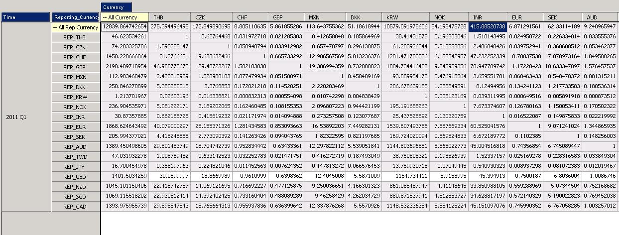

"currency cube" has the converion rates from one currency to another. Pls find the screenshot attached.

I face another challenge now , the data is coming from database which has currency as a dim. Now the issue is that the conversion logic is applied only to amounts. There are other measure elements also like interest rate , origination date etc .
Now when the user selects R_currency for seeing the amount in his local currency , he is getting nulls for all other measure elements. Please find the screenshot below,
Here, the last row with currency 'USD ' is coming from database and it is being converted to Reporting currencies (R_Currency) using the logic
Rep currency = rep currency + conv rate for other currencies. Is there any way to populate other measure elements (like interest rate and date). I tried implementing some rules for doing the same like
