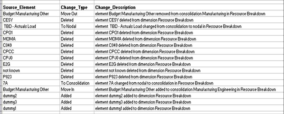

Each time the chore runs, it will compare the 2 versions of the dim and report on any differences. It will output to a dim name / time stamped text file. The format of the file is element name, change type, description and I've copied an example of my test below.
It should report on the following types of change;
To Consolidation = where a nodal element has been changed in to a consolidation (and any data you might have had against it will have gone!).
To Nodal = opposite of above, a consolidation has been changed to a nodal. Quite common when moving elements and "old" consolidations get left behind.
Added = um, easy enough!
Deleted = again, self explanatory
Move In = element X has been added to consolidation Y
Move Out = element X has been removed from consolidation Y
You should always see 2 entries for an element when its moved, one in and one out. If you only see one for the element then its been added (move in) or deleted (move out) from the consolidation, but it existed already (ie. Its not a "new" element like additions are). Its impossible to differentiate those from a move transaction so its important to understand the difference. The descriptions will give you the detail of the elements involved. What it doesn't cover right now is telling you the parent of any additions / deletions. If I added that it'd end up reporting one element twice for 2 reasons, and I'm not sure that’s of much benefit.
