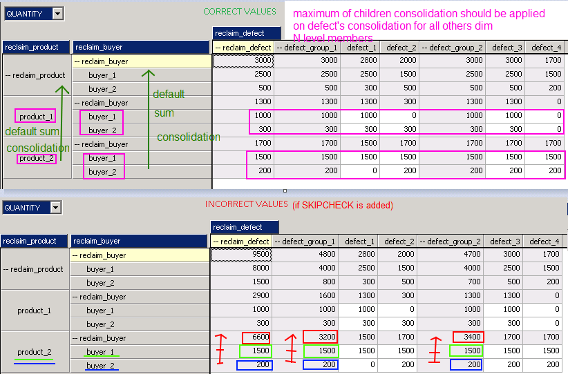

you are right, I should write more about my sample. I have created simple sample to demonstrate the problem (my production cube problem just has the same LOGIC, but just having more dimensions, more members and more measures).
I have a reclaim cube. Each buyer can have a complain about specific product about defects that are related to the product. Single product can have several defects like incorrect color, incorrect size, incorrect shape etc. But if single defect is recognized on particular product, buyer can return this product back to manufacturer. It is quite logical, it is not important if there is single or multiple defects on product, product having single or multiple defects is unusable.
The quantity of defected products returned to manufacturer is measured on intersection buyer and product. For example buyer_1 has complained that product_1 has problems, so buyer_1 returns 1000 products. So far no problem, consolidation of of quantity is done using default sum aggregation on product and on buyer dimension.
But now adding reclaim_defect dimension things get more complicated. For example: buyer_1 has reported two defects on product_1. Defects are: defect_1 and defect_3. In N level we import data 1000 quantity for intersection buyer_1 | product_1 | defect_1 and ALSO!!! 1000 quantity defected products for intersection buyer_1 | product_1 | defect_3. This quantity should NOT be summed on reclaim_defect consolidation levels, because it would produce incorrect values of 2000.
Now consolidation: on buyer and product there should be default sum consolidation. But on reclaim_defect dimension it should be a "maximum of children" consolidation. Having two types of consolidation (sum on buyer and product dimensions and max of children on defect dimension) produces two different values at consolidation levels, to avoid this problem "max of children" logic should only be applied to all of the defect dimension levels, but only if other dimensions like buyer and product are on N level (see purple rectangle on first picture).
Formula published in my first post of this thread solves this maximum of children consolidation problem.
Note: in order to formula work correctly the reclaim_defect dimension has to be reordered to the last position (In TM1 Architect right click on Re-order Dimensions | New order: reclaim_defect should be listed last).
So far so good, but adding this formula to production cube it gets terrible performances. So I have added SKIPCHECK in rules. But by adding SKIPCHECK I get incorrect values (see picture at bottom). It looks like consolidation on reclaim_defect overwrites buyer and product consolidation if SKIPCHECK is turned on.
So I am now stuck at the feeders. I have read several documents about feeders, but all of them are related to multiple measures, feeding one measure into another, but in my case I have only one measure.
How to write feeders for this sample?
P.S. I am attaching dim and cub files in zip file attachment for this sample, so you can look at my sample.
Any idea is greatly appreciated. I am struggling with this problem for months.

I have tried to play around with the code and replacing STET statement from formula with ConsolidateChildren it does solve the problem. So it looks like there was a rule problem. On this simple sample cube I can comment out SKIPCHECK or having this command and get the same result. Also dimension order is not important anymore - I can sort dimension in any way I want to and rules works correctly each time.
SKIPCHECK;
['QUANTITY'] = C:
IF(
	ELLEV('reclaim_buyer', !reclaim_buyer)= 0 &
	ELLEV('reclaim_product', !reclaim_product)=0
	ConsolidatedMax(0,'', !reclaim_buyer, !reclaim_defect, 'QUANTITY',!reclaim_product)
	ConsolidateChildren('reclaim_buyer','reclaim_product')
At the moment it looks like this is THE solution, but I really need to test this rule on production cube to see if there is some glitch in there or not.
But still this does look strange:
1. it looks like default calculating each cells it respects dimension order
2. if skipcheck command is added then sparse calculation engine does not respects dimension order anymore.
Don't know if this is a bug or intentional, but it does look strange to me.
