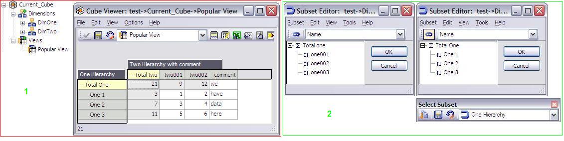

So this is our start point, we have a Current_Cube cube with a Popular View view and data in it (1), this view uses a One Hierarchy subset for dimension DimOne (2) - large pictures but I was limited to 3 attachments:
1. Existing Cube.JPG (65.32 KiB) Viewed 9935 times

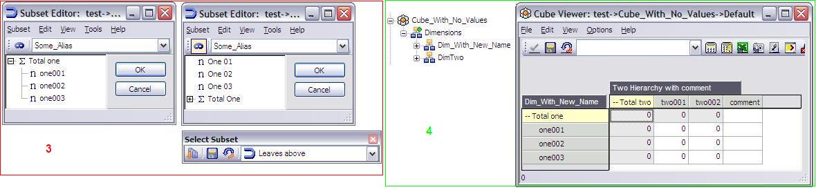

We now want to substitute DimOne name with Dim_With_New_Name name. In order to do it we need to create such a dimension. We can do it e.g. manually from the scratch (like in my exapmle). I created it with a new alias and new Leaves above subset (3). Using this dimension I created a new empty cube that has the dimensions I want my Current_Cube to have. I called it Cube_With_No_Values (4):
2. New Dim And Temp Cube.JPG (62.33 KiB) Viewed 9935 times

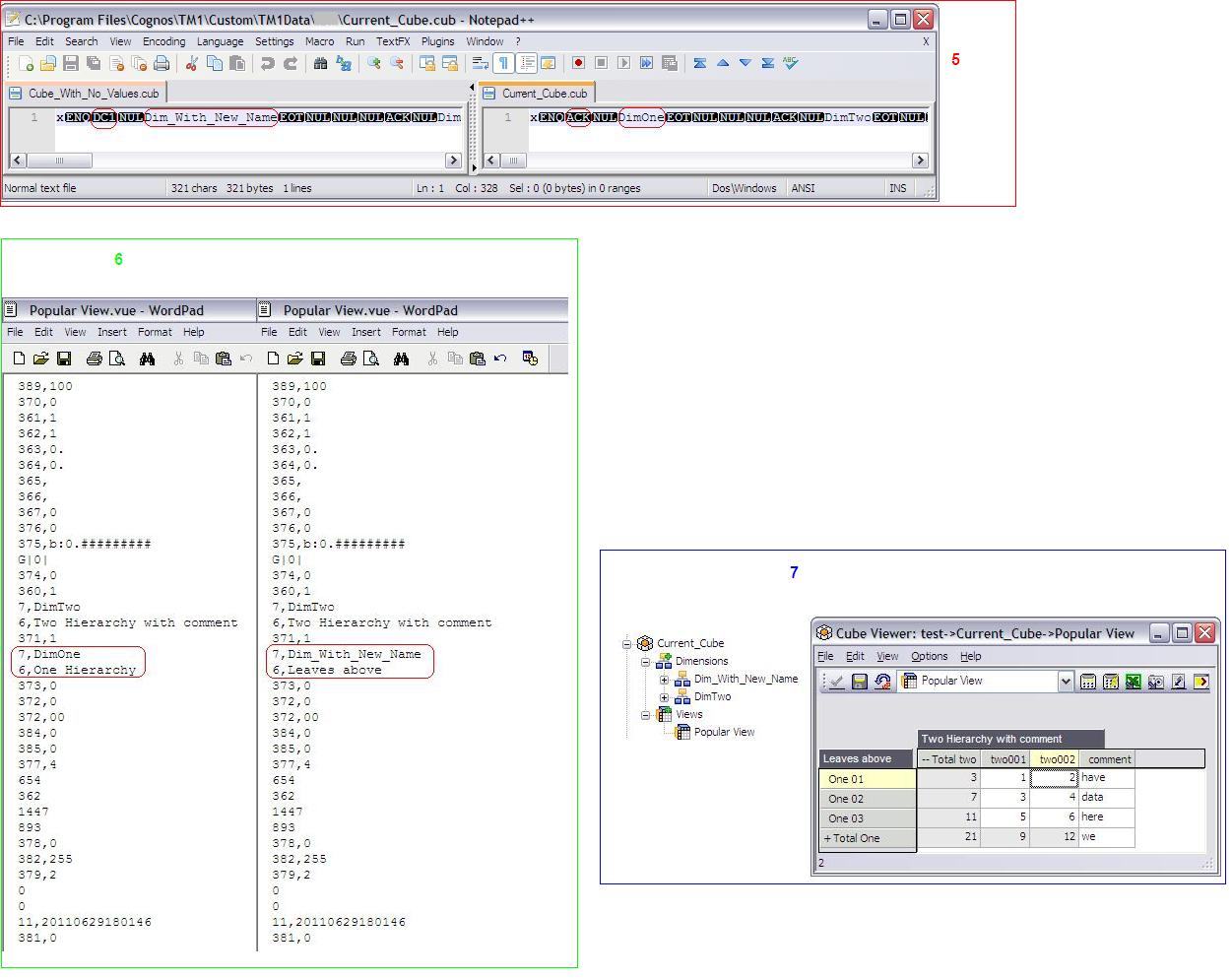

Now it's time to lay down the server and dig in binaries. I opened .cub files for both cubes in Notepad++ with (Encoding->Encode in ANSI) and looked at differences in both files in the "dimension names" area at the beginning of the file (5 - red frames with round edges). Old cube file (with data) is larger, but we are interested in first section that we want to make the same as in new cube.
In this particular case it was enough to delete the [ACK] and [DimOne] and copy-paste the [DC1] and [Dim_With_New_Name] respectively. Some of the "black" boxes are not that simple to copy, but there is workaround to this (e.g. to "create" [NUL] box you type in 00 and then chose TextFX->TextFX Convert->Convert Hex to text from the menu).
Next step I went to Popular View.vue file and changed old dimension name to new one, also changed the subset name(6).
After picking the server up we get a nice result with new dimension name, view that is ready to open and data! (7).
3. Corrections and Effect.JPG (152.75 KiB) Viewed 9935 times
