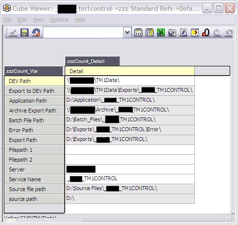

create a cube that holds the filepath. depends on how complex your folder structures are but it could even just hold a server name / share (ie. ServerBob/ShareCrisps). The TI can grab that value as a variable & add anything extra it may need (filename, extra folders etc). You can then use the prolog of the TI to set the datasource as it gets processed, the TIs are indentical between all servers and all you need to maintain is the cube holding the filepaths in each server instance.
In the prolog;
sFile = cellgets ( 'cubename' , 'source file path' , 'detail' );
DatasourceNameForServer = sFile;
DatasourceNameForClient = sFile;
