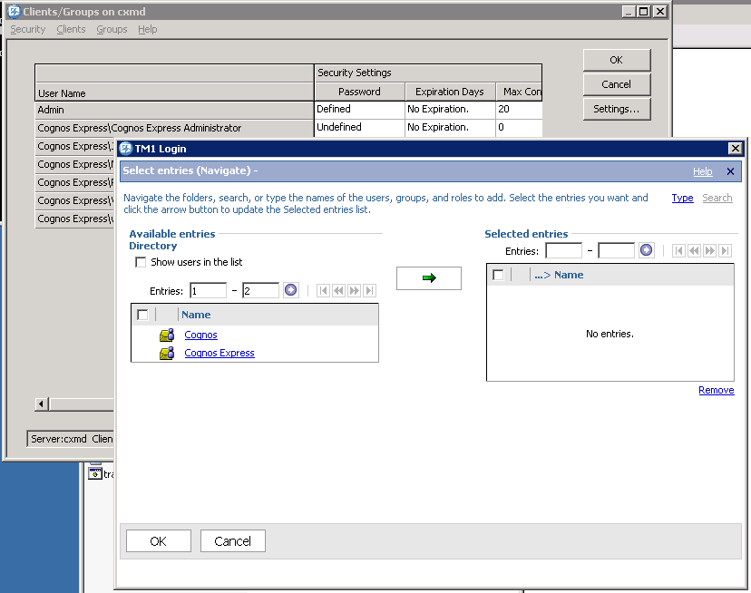

Currently I am using Cognos Express 9.5. I changed my tm1s.cfg settings to IntegratedSecurityMode = 1. When i try adding a new client, I can only add those user which i add in Cognos Exprss Manager. Is there a way I can add a user without going through Cognos Express Manager ?

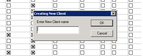

I am still confused. The first picture is showing TM1 9.1 where I can just add a new user directly. Second picture is after i migrate to Cognos Express 9.5. with the new Cognos Express 9.5, I can add user using Congos Express Manager but I do not know how I can login using IntegratedSecurityMode = 1.I create the following user on Cognos Express Manager
Username : tim.burton
Given Name : Tim
Surname : Burton
Password : timburton
But when i click "Add new client", It is showing "Cognos Express\Tim Burton" as the username and password is undefine.
