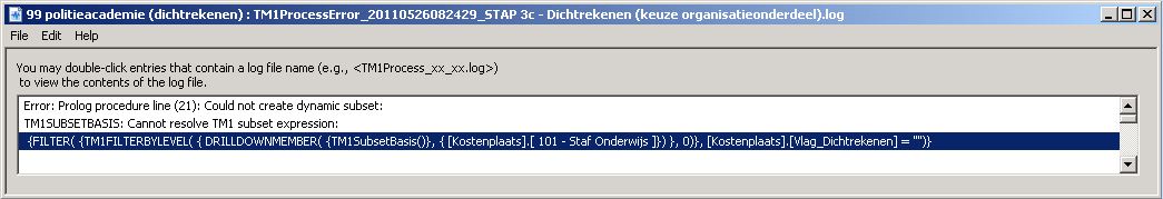

Thanks for your reply. I've tried your suggestions but I still receive an 'unable to resolve TM1 subset expression' (see attached screenshot).
The good news however is that in the expression in the error, you can see that he has replaced the parameter with the correct value from the prompt.
(There are some other manipulations going on but in general it should work, I've tried it in the expression window of the subset).
Do you see any other problem?

Hi Mathias,
i think your problem is with the TM1SubsetBasis() function. You should replace this with the actual 'subset base' selection (probably [Kostenplaats].[101 - Staf Onderwijs]).
Michel
Michel

Re: SubsetCreatebyMDX in combination with parameters
Hi.
Michel is right - it's the TM1SubsetBasis that's a problem - sorry didn't notice that.
Looks like you want the 0 level of the consolidation '101 - Staf Onderwijs' in the dimension 'Kostenplaats'. Try the following - just substitute what you need to in the first 3 lines:
