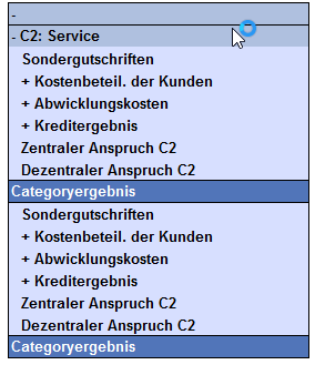

I encounter also to this problem, and also to an TM1RPTROW-Formula, which doesn't resolve the subset in Perspectives, but later in TM1Web it does.
My version indeed is 10.2.0 FP3 and my Excel is 2013 (for development clientside) resp. 2010 (on the server). Here the appearence:
I deleted all left {AR}xy sheets hidden from development, as actually all TM1RPTROW-formulas are driven by a named subset (Sprache means language and refers an Alias, which works as all labels are correctly in german):
=TM1RPTROW(ViewBlock4;"Servername:DIM_KPI";"Block4";"";Sprache;0)
(this one appears empty above, "-")
=TM1RPTROW(ViewBlock5;"Servername:DIM_KPI";"Block5";"";Sprache;0)
(this one appears with it's duplicated hierarchy below; which is not found similarly in the subset itself)
Also I tried "rebuild the workbook" and "rebuild the sheet" in the TM1/Active Report - menu.
I found only the older postings above about this error, but nothing newer. Is there a known best practice I could have missed?
Stefan

Have you deleted all rows under the top row (which contains the TM1rptrow formula before saving the sheet?
This is considered best practice as; in addition to improving performance upon opening - if not done you can end up with leftover rows that are technically under the active form and no longer attached to it.

Declan, thank you very much.
Simple and helpful, it is back in the desired condition regarding the duplicates. The missing headline "-" stays, but is filled in TM1web, which is the important thing.
