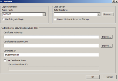

In File | Options there is "Connect to Local Server on Startup" which in my case is unchecked, but I still get this message when exiting TM1 Architect.
