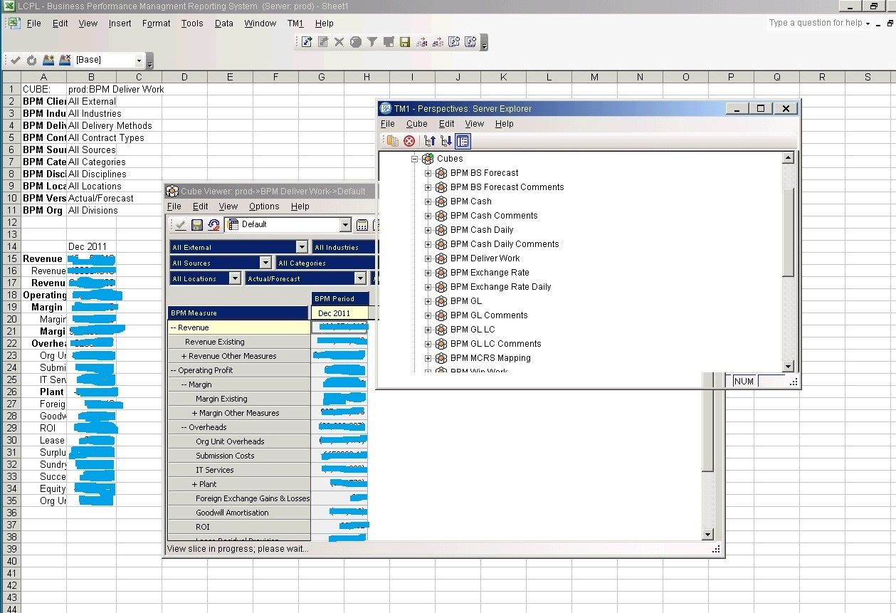

We have the same issue of slicing hanging the Excel session despite unchecking "Ignore Other Applications" box in Excel. Any help will be greatly appreciated. Thanks in advance.
Our TM1 and Excel versions are:
TM1 Perspective version in Citrix: 9.5.1
TM1 Server version: 9.5.1
Excel version: Excel 2003 (11.6560.6568) SP2
Some observations are:
- Slicing works 100% fine with TM1 Perspective on user's Local machine.
- Slicing in Citrix issue is intermittent - it sometimes works and sometimes doesnt. Some users seem to have more success with Slicing in Citrix than others.
- When it hangs we can see that numbers are actually exported to a new worksheet in the background, but cube viewer doesnt seem to release the control and hence hangs excel session. See attached a screenshot.
- Slicing works 100% fine for all users in a separate TEST Citrix box even though it doesnt work in the produciton Citrix boxes. We asked IT whats different in the test Citrix box - the response was they are identical. Instead IT have asked for specific things that need comparing between these two boxes. Would be great if you could recommend what excactly needs comparing in this scenario.
TM1 Cube Slice hangs Excel 2003 in Citrix.jpg (320.87 KiB) Viewed 3596 times
