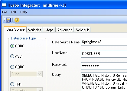

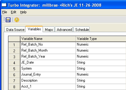

I built a TI process that connects via an ODBC connection to our transaction database. The purpose of the cube is to manipulate the data into a definied ascii journal entry format, then import the file into our general ledger (the general ledger and transaction system are separate). I thought I had the process figured out, until I tried to import one of the journal entries. One of the batches was not balanced, and that is when I discovered that some of the records were not being included in the cube. When I run the TI process, I don't get any errors. I've never seen this problem with any TI process I've built- if there are records that are not going to be included in the cube, they show up in the error log. I have attached jpg's of some of the TI tabs. I tried to attach more than 3 images, but I guess I can't post more than that. I appreciate your time and consideration. Thanks!

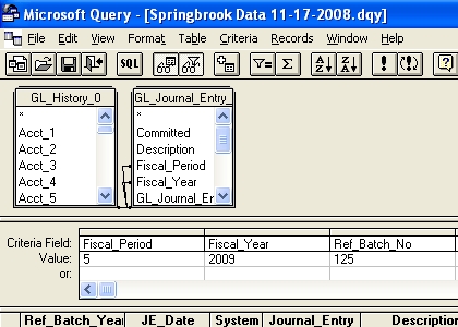

Here's a view of the data preview

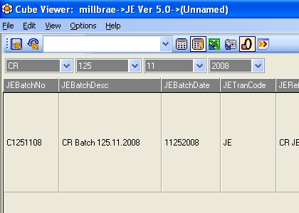

Here's a cube view. This actually is one of the problem batches- where records are missing.
Here's a shot of the data, specifically for the same data criteria parameters as the cube view:
If you compare the cube view to the raw data, you can tell that the cube view is missing two records- the one for $1135.00 and $848.00. I hope this makes sense.
