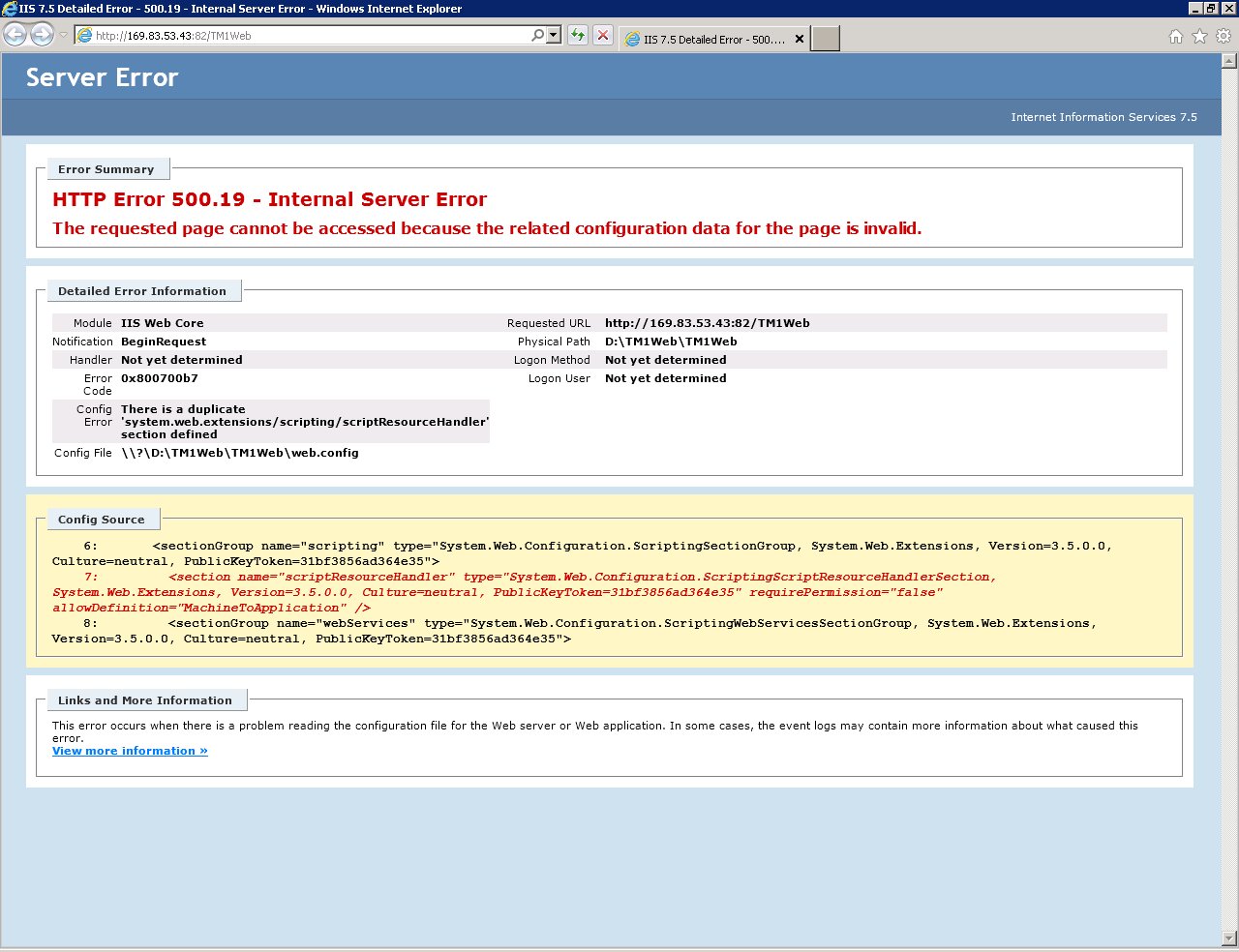

The good news is my previous problem has gone away. The bad news is that it has been replaced by a new one. The error message I'm getting now is:
Any pointers will be greatly appreciated. By me and my darling wife who has to put up with me at the end of the day!!
Jim.

Have you checked the web.config file as indicated in the error for the duplicate scriptResourceHandler sections?
