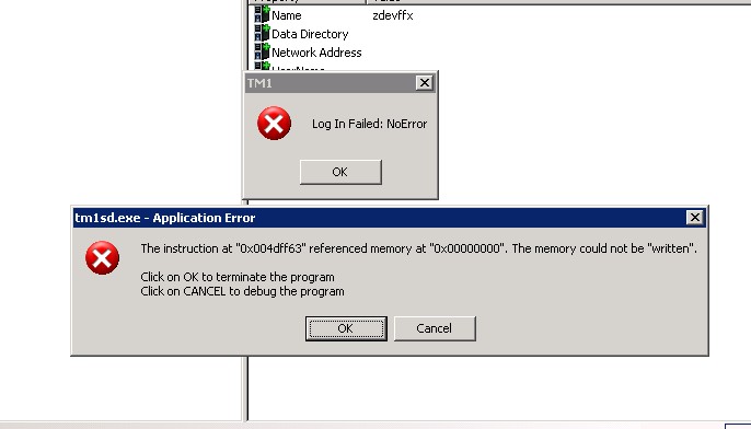

On this occasion TM1 Top WAS able to connect to the server, but as soon as I tried to log in I got the message shown in the attached screen shot: "Log In Failed: No Error"
"No error" other than the fact that it crashed the server with the traditional 9.1 "The memory could not be 'written' " dialog that had to be cleared on the server box before the server session would restart, anyway.

3856 ERROR 2008-11-17 00:51:07,764 TM1.Server.Memory BIGAllocBlock - alloc (size = 150110) failed: Not enough storage is available to process this command.
3856 WARN 2008-11-17 00:51:16,764 TM1.Server.Memory al_Alloc() outOfMemory Exception <<< MEMORY_ALMOST_FATAL_LEVEL >>> - threadID "3856" - apifunc# "1"
3856 INFO 2008-11-17 00:51:16,795 TM1.Server Out of Memory - Last client gone, aborting
3856 FATAL 2008-11-17 00:51:16,795 TM1.Server Server terminated
