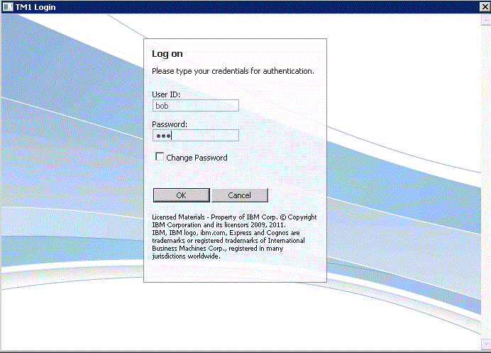

There is actually a command called NET_CONN
Run ("NET_CONN")
But then the user must put the client ID and password frist (before choosing the server ID)
However the user would still need to authenticate with the CAM screen
Ideally I would like to invoke this final screen or pass the user ID and password to both of these via a VBA screen.
