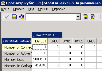

just deleted all files from data folder to test garbage - and get non zero garbage memory value. is it normal? shouldn't it be zero?
Re: TM1 Garbage Memory
ioscat wrote:just deleted all files from data folder to test garbage - and get non zero garbage memory value. is it normal? shouldn't it be zero?
Oh dear, oh dear. I thought we had gotten a bit further than this. What exactly would you think that any FILES would have to do with anything? Remember the TM1 server is completely in memory, the data directory files only represent a static copy of the database at a point in time. Also be very careful with deleting any files in the data directory while the server is in session as this can cause instability (i.e. crashes).
ioscat
Posts: 209
OLAP Product: Contributor
Version: 9.5.2 10.1.1 10.2
Excel Version: 07+10+13
Post by ioscat »
wow, lotsaram, of course I stopped service, then deleted files and started server again. So, as I suppose, I got "Game over" TM1 server. As you can see, there is only about 9 MB of memory used.
Well I think if you meant that you were starting a server from an empty data directory there were maybe clearer or better ways of phrasing it. ;)
Some garbage memory is normal. It just means that TM1 has requested more memory from the OS that what it currently requires. I don't know why you would be concerned about it.
