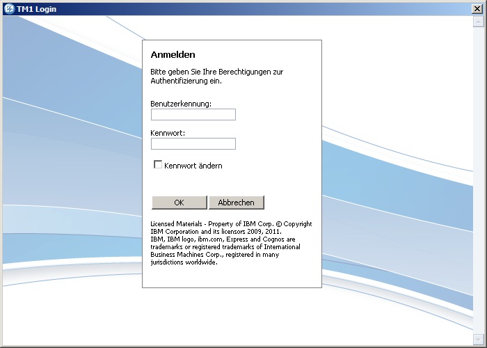

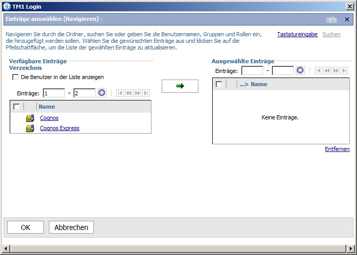

Porting databases from TM1 9.5 to CX9.5 was no problem, changing security mode from 5 to 2 reactivate the TM1 Users for Login. But if i want to create a new user Xcelerator starts the CX security (screenshot). We won't use the CX Security, so is there a posibility to disable the CX Security and using the "old" TM1 Security to create new user and groups? I hope for an additional parameter in the tm1s.cfg or tm1p.ini.

Sorry for the german Screen ;)

Our problem ist not the login into the database, it works with security modes 1-3 and 5, if configured. But i allready # all CAM lines out.

The problem is the security tab creating new users, it show's the logon screen from my first post and leads me to the CX Security window (Screenshot).
And we decided, we won't create new users in this way, and because of this there is the question: How can we get the old security tab back? [Right Click - New User - Tip name - Click Ok - done]
And # out the CAM lines was not the answer, so is there possible a hidden parameter for the cfg, deactivating the CX security? Found nothing about that in the op guide.

You're right - I went back to check, and although the normal login comes up, there still seems to be a hook into the tedious and obscure CAM subsystem for maintaining users and groups. My solution (or rather kludge) was to write a noddy little TI to add users/groups. Apologies. :oops:

I found the solution for this problem. It's a parameter in the tm1p.ini located in "C:\Users\%user%\AppData\Roamin\Applix\TM1\tm1p.ini".
There's the parameter AllowImportCAMClients = T. If it's been switch to F or # it out, Xcelerator ignore the CX Security and it all seems work like the good old TM1.
