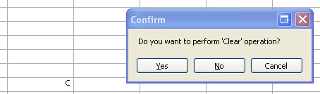

I have an Element of String type. This element will hold the alphabet values from A to Z (single character)
The problem is that when I try to enter alphabet C into this cell, I get the Clear Operation Message box - which is not really what I want in this case.
Any suggestion how the end users will be able to enter the Alpahabets here?
Entering 'C' in a String cell initiate Clear Operation Msg

- Clear Operation Error
- TM1_ClearOpertionError.jpg (17.11 KiB) Viewed 4265 times

You know that bit in the Request For Assistance Guidelines that reads:ExApplix wrote: I have an Element of String type. This element will hold the alphabet values from A to Z (single character)
Yeah, that bit.2) Ensure that you specify the component of the software that you're having a problem with. If someone states that they have a problem with number formatting, people need to know whether that's in Cube Viewer, Web, EV, or wherever.
I'm assuming that this is in Cube Viewer rather than Web or Excel.
Supposedly Iboglix was going to modify the command so that it required a multi-key press. Unfortunately some GUI genius, presumably taking lessons from Vista's designers, decided that a confirmation dialog was a better option. In doing so they overlooked this situation. As I see it your options are:
(a) Slice it to Excel where this doesn't seem to be a problem (in 9.5.1) and do the input from there.
(b) Copy the letter C from another source and paste it into Cube Viewer, which doesn't seem to trigger the dialog; or
(c) Enter multi characters (like "cc") then go back and edit the excess one out.

Thanks Alan!Alan Kirk wrote: I'm assuming that this is in Cube Viewer rather than Web or Excel.
I should have mentioned it before. I am having this problem in the Cube Viewer.
Now I am wondering aside from letter C are there any other letters which I should be worried about?

Not as far as I can recall. All of the other spreading commands are multi-character ones. It's unlikely that you'd want to enter something else that could be interpreted as one of those.ExApplix wrote:Thanks Alan!Alan Kirk wrote: I'm assuming that this is in Cube Viewer rather than Web or Excel.
