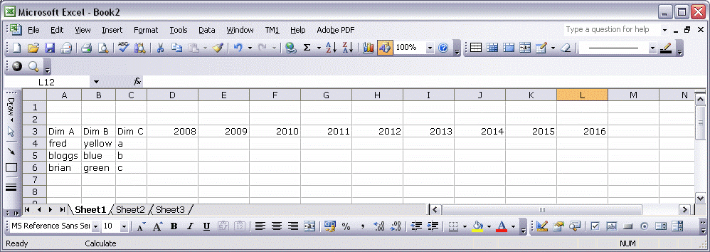

I need to extract in a tabular format data from 3 of those dims down the left side, with years spanning 2008 to 2023 (consolidations of months) across the top for one of our users.
example output
example output
