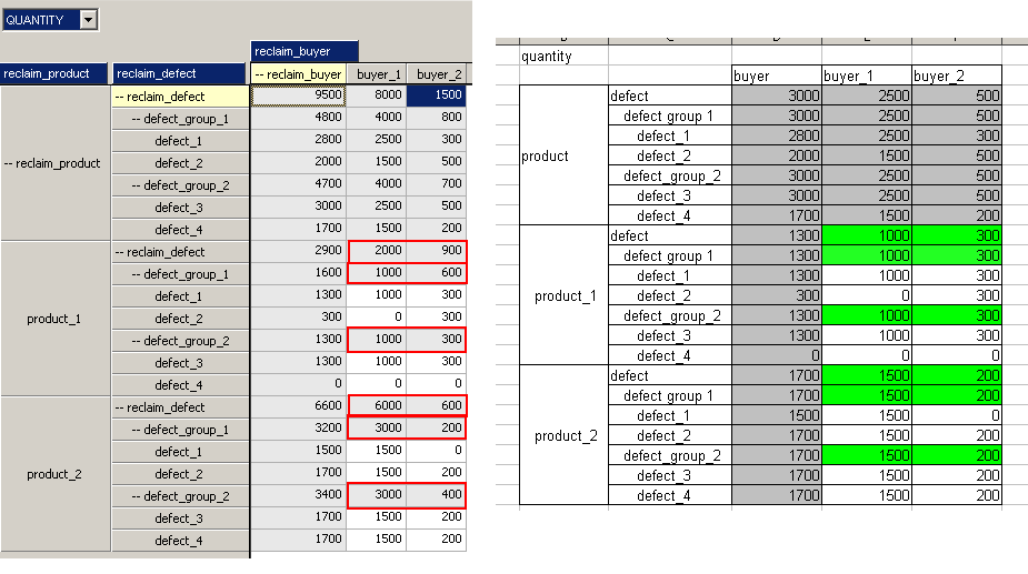

in TM1 v9.5 I created the reclamation cube with the following dimensions:
1. Measure dimension: quantity
2. Product dimension: products --> product_id
3. Buyer dimension: buyers --> buyer_id
4. Defect dimension: defect --> defect_group --> defect_id
Buyer makes official reclaim for particular product. Measure "reclamation quantity" is tracked by buyer_id and product_id!
On single product there can be one or more defects!
I think I need the following consolidation: For product and buyer dimension there should be default sum consolidation. But for defect dimension there should be maximum of children for each level. Like:
defect = max (defect_group)
defect_group = max(defect_id)
Please see attached picture. Left side of picture are data from cube. Red rectangles should be calculated as max(children). On the right site there is spreadsheet of correct values. Green rectangles are using formula max(children).
How to create maximum consolidation to particular dimension (defect dimension) instead of having sum consolidation?

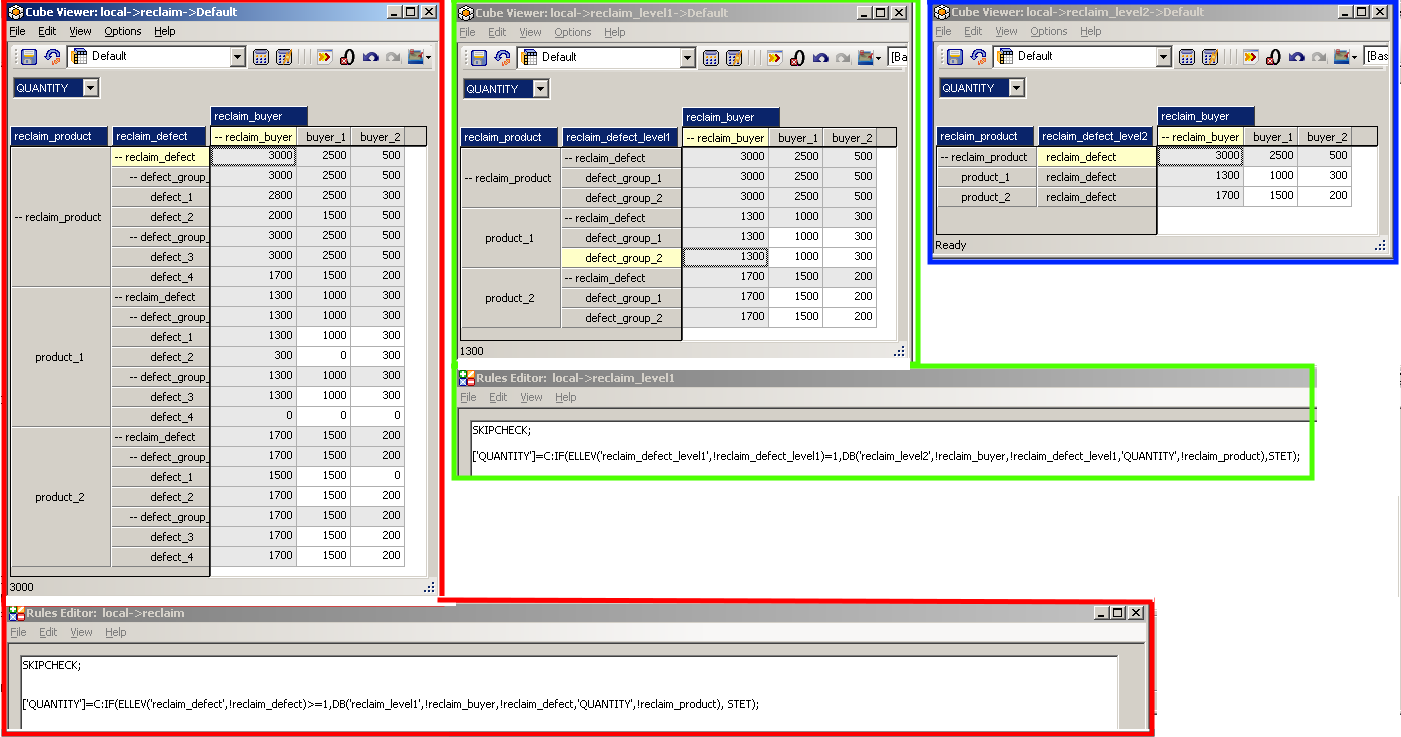

I have manage to solve the problem with solution of having three cubes, one cube for each level of defect dimension. I have created first cube (in picture blue rectangle) for top level, then I have written rules in second cube where I have created defect dimension with top and defect group level (in picture green rectangle) and pull data to consolidated level from first cube with DB function. The last operation was to create third cube with three levels (top, group defect and defect) (in picture red rectangle) and pull data to consolidated levels from second cube. End-user sees only third cube (in picture red rectangle).
This is solution that I have figured out, but I don't really like this solution, because of many thinks:
1. This is only a simple sample and it already looks complicated - the real production sample will be much more complicated (there are 10 dimensions and 17 measures) and so more difficult to maintain.
2. I am afraid there will be performance problems linking all this three cubes.
Does anyone has any other idea how to solve this "maximum" of children problem?

Re: How to consolidate dimension with maximum of children?
Hi abcuser
Have you considered using the "Max" formula in a rule? Something like this:
['Quantity'] = C:
if(Ellev('Defect',!Defect)>0,
Max(DB('Reclamation', !Measure, !Product, !Buyer, Elcomp('Defect',!Defect,1)),
DB('Reclamation', !Measure, !Product, !Buyer, Elcomp('Defect',!Defect,2))),
Continue);
Not sure if this is exactly what you are looking for, but I'm sure it's worth playing around with.

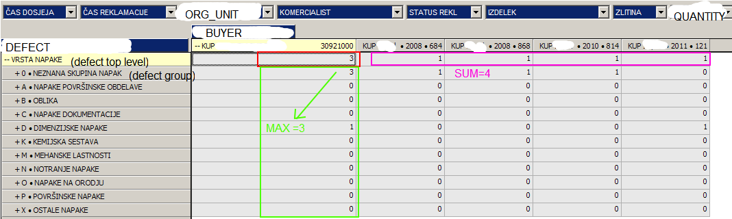

Melissa18,Melissa18 wrote: ['Quantity'] = C:
Continue);
this code works fine for simple sample posted in my first post!!!
Now I have implemented the same logic to my production cube (production cube has the same logic, just more dimensions and more measures). But in production this rule does not work correctly - at top levels of cube I get too small numbers. It looks to me, that "defect" dimension overrides other dimension calculations such as "buyer".
I have attached the production cube print-screen. At picture I have selected Quantity as measure, in rows there is Defect dimension and in columns there is Buyer dimension. I have drawn red rectangle at number 3 (which is incorrectly calculated!). It looks like this number is consolidated as max of children from defect dimension (green rectangle). But if we look at Buyer dimension consolidated value should be sum of buyer dimension children which equals to 4 (purple rectangle). So value in red rectangle should be 4 and not 3!
I hope I am making the correct assumption. If I am, is there any way I can set the calculation order of dimensions? To consolidate buyer dimension first and then defect dimension.
- max_children.png (35.81 KiB) Viewed 40174 times
