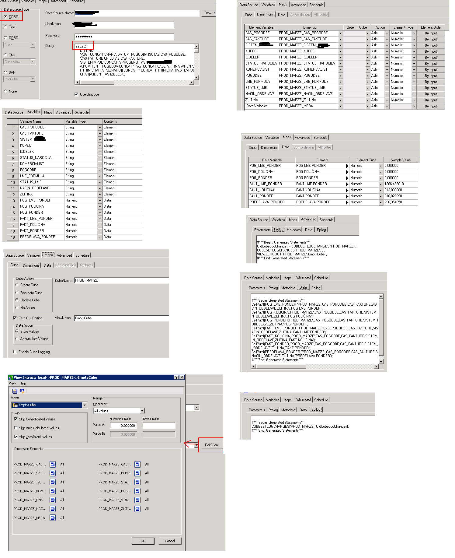

tomok, sorry, I don't understand you question. I don't get any error in TM1 Architect and process is running without any error for a week, but every Monday I get this "Cube does not exist" error.
I have attached print-screens of MY_CUBE process. Please see attachment. Am I doing something wrong?

It looks like the cube PROD_MARZE gets deleted outside of your process, so that when it gets executed it cannot find it and falls over on the first line of code. Are you aware of any other process in your environment that would be deleting this cube periodically?

My thoughts are the same. Namely that if this process is running daily OK except for Monday and it is failing on Monday because the cube has been deleted then the problem is not in this process but in another process/chore that is running sometime between when this process runs on Sunday and when it runs on Monday.
Also if this is supposed to be a production system then I would advise against using any wizard generated code period.

On this cube there are running the following processes:
1. processes to recreate dimensions - all of them having "recreate dimension" option
2. above process that loads data into cube
The error "Cube Not Found" is appearing every Monday and every day after national holiday! All of the jobs running from chore are daily jobs. This are days that no data are refreshed in warehouse database. So it looks to me that some of operation is deleting too much, I am suspecting deleting from zero out view (Prolog command: VIEWZEROOUT command). Is there any other way to all data from cube except using ZeroOut option and using view? I am just trying to do something different to see if error still appears.

Let me just add that you are not providing all the relevant information. This particular error message:
Error: Prolog procedure line (3): Cube "MY_CUBE" Not Found
Is telling me that TM1 is looking for a cube that is literally named "MY_CUBE". According to the screen shots of your TI code, the cube in questions is named "PROD_MARZE" so right there I know there is something missing here. I know TM1 can do some crazy things but there is no way that it can turn "PROD_MARZE" into "MY_CUBE" unless you have some statements programmed into your TI that does that. Go back through your processes and check all the ones that work against this cube. Better yet, do a text search of your data directory for the string "MY_CUBE" and let us know what you find.

qml, I have 7 chores in production this core is the first chore that is run every single day and all other chores are also run every single day. By the way, today in the morning the same problem reappeared and today is not a Monday and it is also not a fist day after a holiday - so my theory is broken. Yesterday everything was OK, so all the chores that run after THE chore are not effecting the problem. Bellow are the processes inside THE chore in the order of executing. Sections are: Prolog, Metadata, Data, Epilog.

DIMENSIONELEMENTINSERT('PROD_MARZE_STATUS_NAROCILA','',STATUS_NAROCILA,'n');
DIMENSIONELEMENTINSERT('PROD_MARZE_STATUS_NAROCILA','',DIM,'c');
DIMENSIONELEMENTINSERT('PROD_MARZE_STATUS_NAROCILA','',SKUPINA_STATUSA_NAROCILA,'c');
DIMENSIONELEMENTCOMPONENTADD('PROD_MARZE_STATUS_NAROCILA',DIM,SKUPINA_STATUSA_NAROCILA,1.000000);
DIMENSIONELEMENTCOMPONENTADD('PROD_MARZE_STATUS_NAROCILA',SKUPINA_STATUSA_NAROCILA,STATUS_NAROCILA,1.000000);
ATTRPUTS(STATUS_NAROCILA_ALIAS,'PROD_MARZE_STATUS_NAROCILA',STATUS_NAROCILA,'STATUS_NAROCILA_ALIAS');
PROCESS: PROD_MARZE_ZLITINA
DIMENSIONDELETEALLELEMENTS('PROD_MARZE_ZLITINA');
DIMENSIONSORTORDER('PROD_MARZE_ZLITINA','ByInput','ASCENDING','ByInput','ASCENDING');
DIMENSIONELEMENTINSERT('PROD_MARZE_ZLITINA','',ZLITINA,'n');
DIMENSIONELEMENTINSERT('PROD_MARZE_ZLITINA','',DIM,'c');
DIMENSIONELEMENTCOMPONENTADD('PROD_MARZE_ZLITINA',DIM,ZLITINA,1.000000);
PROCESS: PROD_MARZE
OldCubeLogChanges = CUBEGETLOGCHANGES('PROD_MARZE');
CUBESETLOGCHANGES('PROD_MARZE', 0);
VIEWZEROOUT('PROD_MARZE','EmptyCube');
CellPutN(POG_LME_PONDER,'PROD_MARZE',CAS_POGODBE,CAS_FAKTURE,SISTEM,KUPEC,IZDELEK,STATUS_NAROCILA,KOMERCIALIST,POGODBE,LME_FORMULA,STATUS_LME,NA
CIN_OBDELAVE,ZLITINA,'POG LME PONDER');
CellPutN(POG_KOLICINA,'PROD_MARZE',CAS_POGODBE,CAS_FAKTURE,SISTEM,KUPEC,IZDELEK,STATUS_NAROCILA,KOMERCIALIST,POGODBE,LME_FORMULA,STATUS_LME,NACI
N_OBDELAVE,ZLITINA,'POG KOLIÄŒINA');
CellPutN(POG_PONDER,'PROD_MARZE',CAS_POGODBE,CAS_FAKTURE,SISTEM,KUPEC,IZDELEK,STATUS_NAROCILA,KOMERCIALIST,POGODBE,LME_FORMULA,STATUS_LME,NACIN_
OBDELAVE,ZLITINA,'POG PONDER');
CellPutN(FAKT_LME_PONDER,'PROD_MARZE',CAS_POGODBE,CAS_FAKTURE,SISTEM,KUPEC,IZDELEK,STATUS_NAROCILA,KOMERCIALIST,POGODBE,LME_FORMULA,STATUS_LME,N
ACIN_OBDELAVE,ZLITINA,'FAKT LME PONDER');
CellPutN(FAKT_KOLICINA,'PROD_MARZE',CAS_POGODBE,CAS_FAKTURE,SISTEM,KUPEC,IZDELEK,STATUS_NAROCILA,KOMERCIALIST,POGODBE,LME_FORMULA,STATUS_LME,NAC
IN_OBDELAVE,ZLITINA,'FAKT KOLIÄŒINA');
CellPutN(FAKT_PONDER,'PROD_MARZE',CAS_POGODBE,CAS_FAKTURE,SISTEM,KUPEC,IZDELEK,STATUS_NAROCILA,KOMERCIALIST,POGODBE,LME_FORMULA,STATUS_LME,NACIN
_OBDELAVE,ZLITINA,'FAKT PONDER');
CellPutN(PREDELAVA_PONDER,'PROD_MARZE',CAS_POGODBE,CAS_FAKTURE,SISTEM,KUPEC,IZDELEK,STATUS_NAROCILA,KOMERCIALIST,POGODBE,LME_FORMULA,STATUS_LME,
NACIN_OBDELAVE,ZLITINA,'PREDELAVA PONDER');
CUBESETLOGCHANGES('PROD_MARZE', OldCubeLogChanges);
qml
Posts: 1098
Excel Version: 2007 - 2016
Location: London, UK, Europe
Re: Error: Prolog procedure line (3): Cube "MyCube" Not Foun
Post by qml »
I can't see any code that would remove / rebuild the cube, so it must be something else. Maybe you can go through your other chores/processes and search for anything like
CubeDestroy('PROD_MARZE');
I really can't think of anything else right now.
Kamil Arendt
