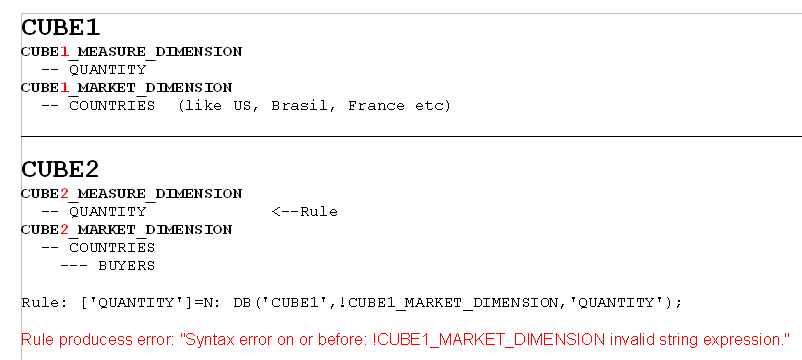

How to write DB function in rules if cubes have different di
abcuser
- Posts: 133
- Version: 9.5.2
- Excel Version: 0
in Cognos TM1 v9.5 I have two cubes which have the same members but have different dimension name.
When I use DB function in rule I get error: "Syntax error on or before: !CUBE1_MARKET_DIMENSION invalid string expression." I think the error is because dimensions from two cubes don't have the same name.
How to write a DB formula to tell TM1 server that I have two cubes with different names?
See attached file for simple sample.

- Posts: 1458
Re: How to write DB function in rules if cubes have differen
(Just posted this in IBM Developerworks - but you're much better off posting here.)
To link cubes with different dimensions, just use (say)
!Cube2_market_dimension
in your rule - assuming that's the name of the dimension in the cube the rule resides. Then matching elements will pull through.
If you need to do lookups, use an attribute. Remember to create and use the inverse attribute for the feeder. (That's why I prefer to simply use matching elements if possible.)
HTH
HTH

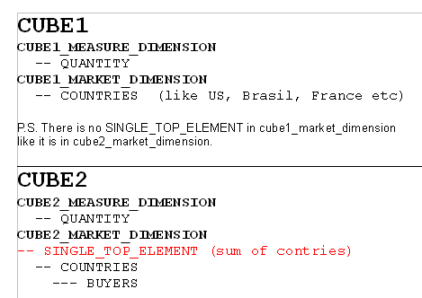

abcuser
- Posts: 133
- Version: 9.5.2
- Excel Version: 0
David,
thanks a lot for answer. I changed !cube1_market_dimension with !cube2_market_dimension and error disappeared, but I get zeros for "quantity" in whole cube.
I have figured out that using formula without "N:" (and changing !cube1... to !cube2...) it displays data in cube2 at dimension level "countries" which is ok, but on countries summary level "first single top element in market dimension" has zero displayed, but I would like to have a sum of child countries. This zero overwrite at top_most_countries_level is most probably because I have removed "N:" from formula. But is it some way that I can create sum of "countries" at top_most_countries_level? So is there something like [top_most_countries_level]=sum(children[top_most_countries_level])) or some other way to get a sum to top_most_countries_level?
P.S. Are feeders really needed? If I am not mistaken there are only for performance reasons, am I right?
P.S. I have attached new picture (marked red for single_top_element in market dimension).

abcuser
- Posts: 133
- Version: 9.5.2
- Excel Version: 0
lotsaram,
this is only very simple sample of the problem I have. Cube1 in my real system has only two dimensions and all of the cells has a data, so cube is 100% dense. Cube2 in my real system has 8 dimensions, but I have omitted them in my simple sample to simplify my problem. I do use "skipcheck;" command, but without "feeders;" command and corresponding feeders.
OK, that is about performance, but what about my main problem. Using formula:
['QUANTITY']=DB('CUBE1,!CUBE2_MARKET_DIMENSION,'QUANTITY');
(so !cube2_market_dimension and without N:) I have zeros at "single_top_element" in cube2_market_dimension. How to get data to this upper level - sum of countries?

OK I can see that you are stuck with what is bad cube design but due to your restrictions on report UI there is nothing you can do about it. A mechanism to build "meta views" or "meta cross-tabs" in TM1 is very long overdue where views from different cubes can be stitched together and share title elements! Something like this would avoid your issue altogether.
But that aside your issue has a very straightforward cause and equally straightforward resolution. You said very early on that "there is no top level consolidated node in cube 1 market dimension like there is in cube 2 market dimension." Well basically YOU NEED ONE. As you have written a global rule for "Quantity" this rule applies to all members of all other dimensions excluding the measure dimension. The rule works to collect data from the countries level because these members exist in the other dimension you see a value of zero for the top level consolidation because the same rule applies to calculate it yet when TM1 resolves the rule and checks for a value in the other cube the member does not exist so consequently (and rightly and logically) the value returned is zero.
In your case you don't need an N: rule as you don't actually want to consolidate values in the target cube but you appear to be under a misapprehension of what the N: and C: rule qualifiers do. The N: qualifier is best understood as a filter for the area statement. It has nothing to do with where the data is coming FROM. In your instance yes you are pulling consolidated data from another cube but this does not mean the N: qualifier is inappropriate, if you want to pull data into a cell that has leaf elements on all dimensions and consolidate it then that is what the N: qualifier is for. In your instance though you don't want to do this as it would result in aggregation which you don't want as you want to see the same quantity for many different levels and intersections in your target cube. As long as you don't need to see quantity with null suppression on then in this specific case you do not need to feed quantity. If you do want to display with null suppression on then you have a problem.
If you do want to aggregate quantity in the target cube then you will need feeders and you could also try ConsolidateChildren('Cube2_market_dimension'). I think for the design you have you are much better off creating the consolidations that are missing in Cube1_market_dimension though as this will do the trick for you!
I think for your level of understanding at this point there is not much point trying to explain conditional feeders.

Now I have added the top member in cube1.lotsaram wrote:But that aside your issue has a very straightforward cause and equally straightforward resolution. You said very early on that "there is no top level consolidated node in cube 1 market dimension like there is in cube 2 market dimension." Well basically YOU NEED ONE. As you have written a global rule for "Quantity" this rule applies to all members of all other dimensions excluding the measure dimension. The rule works to collect data from the countries level because these members exist in the other dimension you see a value of zero for the top level consolidation because the same rule applies to calculate it yet when TM1 resolves the rule and checks for a value in the other cube the member does not exist so consequently (and rightly and logically) the value returned is zero.
I have removed the N:lotsaram wrote:In your case you don't need an N: rule as you don't actually want to consolidate values in the target cube... if you want to pull data into a cell that has leaf elements on all dimensions and consolidate it then that is what the N: qualifier is for. In your instance though you don't want to do this ...
Problem solved.
Thanks a lot for detailed explanation. I have learned so much from this thread. This forum rock!
