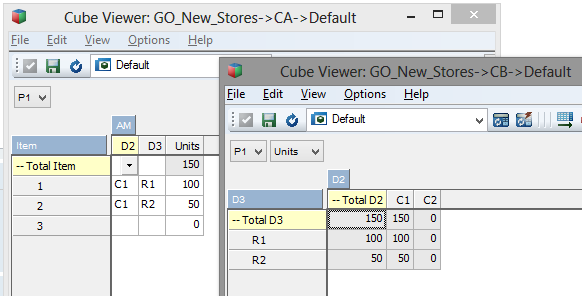

by rambo
You can now achieve this WITHOUT an item dimension in the summary cube. Performance Modeler will let you do this. It creates a few control cubes in the background (behind even control objects) to achieve this. Very useful stuff. I have attached couple of screenshots showing this functionality.

by mvaspal
I would be very cautious with this built-in functionality, especially when you are using virtual dimensions in the source cube. You should always check the generated code and feeders and then decide whether you keep it or go rather the self-developed TI way.
