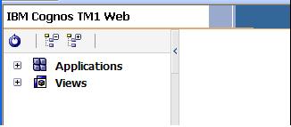

The result must be hidden as follow attach file but the Administration node still display
Can anyone give me solution or workaround to hide Administration node on Tm1web?

I'm a little confused by your post as perhaps are others. Is the screenshot you attached from your system after your changes or is it from the IBM reference material? If the image is taken from your system then YOU HAVE HIDDEN THE ADMINISTRATION NODE.
The Tm1 Web navigation pane shows in order the trees for application folders and entries, Cubes and views (for some reason just called "views" in web) and Administration The Administration tree in TM1 web has options for changing password and running processes (and other options if you happen to be an admin user) The image you attached does not show the Administration node in the navigation pane, therefore I assume your web.config change was successful. (If you attached the wrong image did you also restart IIS after making the change to web.config as this is also essential?)

Could be a known bug, does the below (especially the detail about what's shown under the "Administrator" node) match your situation? You haven't given any information on your environment, and my guess is that screenshot is from the documentation, not your system.

I've posted the result from the IBM reference material.but in fact it didn't appear like that.
