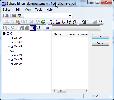

Not necessarily. If the data source serves the months up in order such that they're added to the dimension in the correct sequence (and granted, this is a critical proviso given that the only two options are 'ByInput' and 'ByName') then this:
DimensionSortOrder( SC_DIMNAME, 'ByInput', '', 'ByHierarchy' , '');
used like so:
SC_DIMNAME = 'PeriodExample';
DimensionCreate (SC_DIMNAME);
DimensionElementInsert (SC_DIMNAME,'', 'Jan 09','N');
DimensionElementInsert (SC_DIMNAME,'', 'Feb 09','N');
DimensionElementInsert (SC_DIMNAME,'', 'Mar 09','N');
DimensionElementInsert (SC_DIMNAME,'', 'Apr 09','N');
DimensionElementInsert (SC_DIMNAME,'', 'May 09','N');
DimensionElementInsert (SC_DIMNAME,'', 'Jun 09','N');
DimensionElementInsert ( SC_DIMNAME,'', 'Q1','C');
DimensionElementInsert ( SC_DIMNAME,'', 'Q2','C');
DimensionElementComponentAdd(SC_DIMNAME , 'Q1', 'Jan 09', 1);
DimensionElementComponentAdd(SC_DIMNAME , 'Q1', 'Feb 09', 1);
DimensionElementComponentAdd(SC_DIMNAME , 'Q1', 'Mar 09', 1);
DimensionElementComponentAdd(SC_DIMNAME , 'Q2', 'Apr 09', 1);
DimensionElementComponentAdd(SC_DIMNAME , 'Q2', 'May 09', 1);
DimensionElementComponentAdd(SC_DIMNAME , 'Q2', 'Jun 09', 1);
will yield this:
Which is what I think the original poster was after.

Alan's screenshot shows what I'm trying to achieve.
